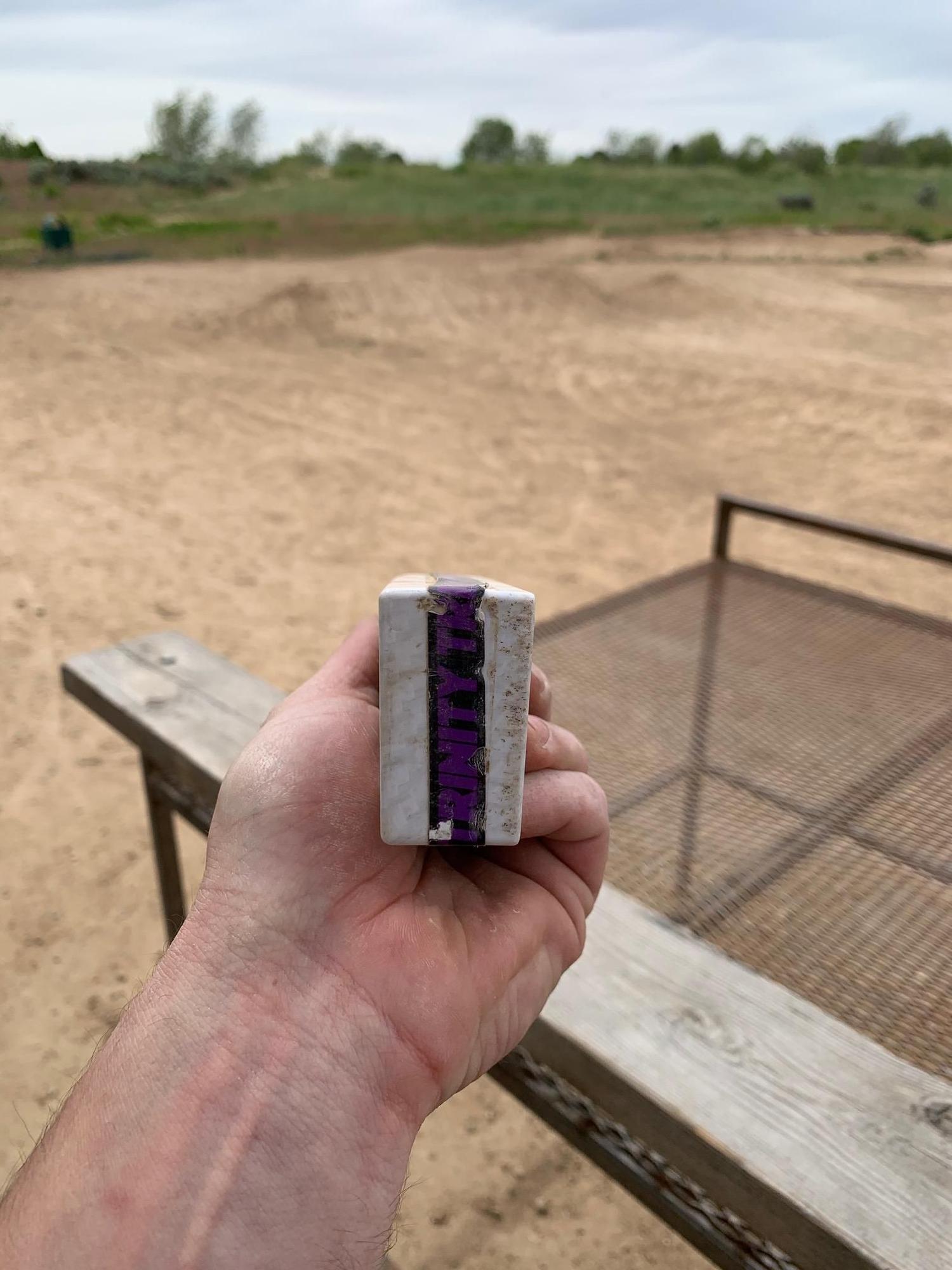

So I recently purchased a used battery from a member here. I balance charged it @ 5amps, ran it a single run in my SCTE (along with my 3 other batteries) and noticed its severely puffed. The seller had a single top down picture in the post and no mention of any issues or puffing with the battery. This is just about ready to break out the case and I dont even want to charge it in its current state. I have 5 other *cheap* duratrax/venom/promatch batteries that ive run for years and never had any puffing in this same truck/setup.
So what does R/C Tech think? Am I in the wrong to request a full refund for the battery? I mean I get that its *used* and there is a risk to buying any second hand product and i did charge it. But I dont care about low IR, not having the full capacity, etc, I just want a battery that will charge will out me fearing its going to burn down my house. For full disclosure, I did not fully question the batteries state (would expect that to be on the seller) nor did I ask for any additional pictures.. Heres the batt.

For me its hard to see how puffed it is in the picture but i assume that the tape around the edge is all screwed up because of the puff. If that is the case and its barely holding together your absolutely right - not safe and I would say that its not used - its used up. I dont think charging the battery in this case means you accepted full liability - running it makes it alittle more grey but it sounds like you didn't notice anything was wrong until after.
Looking at the original pic from the ad it looks fine. In combination with the clean other cars and battery I dont think I would of asked any questions either.
I would contact the seller and see what you can work out. Might be a little bit of caveat emptor on your part along with as seller that was less then honest with the representation of the batteries actual condition. Every story has two sides but you seem to be in the right to ask for a refund but you might need to eat shipping it back.

and you didnt noticed if it was puffed when you received it and before you charged it? from reading your post it puffed after you ran it

I did not notice it when I first got it. But it did show up right as I was leaving to the track, so I ran and threw it on my charger right away without a full inspection. It does seem if it was puffed before hand, it probably wasnt as swollen as it is now, but I sometimes do miss things right in front of me when in a hurry. You think because I cycled it once, I should now be fully responsible?
I did contact the seller on Saturday. I offered to come up with some compromise without me getting a full refund (like %50 the asking price) since I did charge it and there is a chance it just went bad at the same time. They have updated their post and ignored my message. I would be happy to meet in the middle, but if they arent going to respond, then I guess I have to go to paypal? I really feel like someone sold me a *bad* item.. But maybe I just have the wrong idea of how it should work...

When it comes to the settings it was balance charged with max voltage of 8.40v(4.2 per cell) @5amps on a Venom Pro duo. I charged a total of 4 of my 2 cells lipos. Running a hobbywing xr8 Sct with the hobbywing 3660 combo that currently has the auto cutoff voltage setting that cuts out at 6.2v for a 2 cell. I ran all 4 batteries until cut off, which usually gives about 15min runtime. Its wasnt a particularly hard run. This was the last battery for the day and we were all packed up, so I immediately removed the battery to put in the lipo bag. It was warm, but neither the battery or the connectors were hot to the touch. Every other batt has performed this same task flawlessly for years. And they are reaching 3 years old. Why i was looking for another battery in the first place. So did i do something wrong here?

Cant say you did anything wrong with how you charged the battery or ran it - personally i like to only run my batteries down that low (3.2volts) but its fine. I would say you can cycle the battery and verify its capacity and watch to see how far out of balance it gets when you discharge. Those are good signs of a battery that is tired. If the pack is not coming off any warmer then your other batteries and the voltage between cells is with maybe .2 volts then maybe its ok. It doesn't look that out of square but the tape is maybe making it look worse!
Or discharge and dispose of safely and chalk it up to a cheap lesson learned before it gets to be an expensive lesson.
