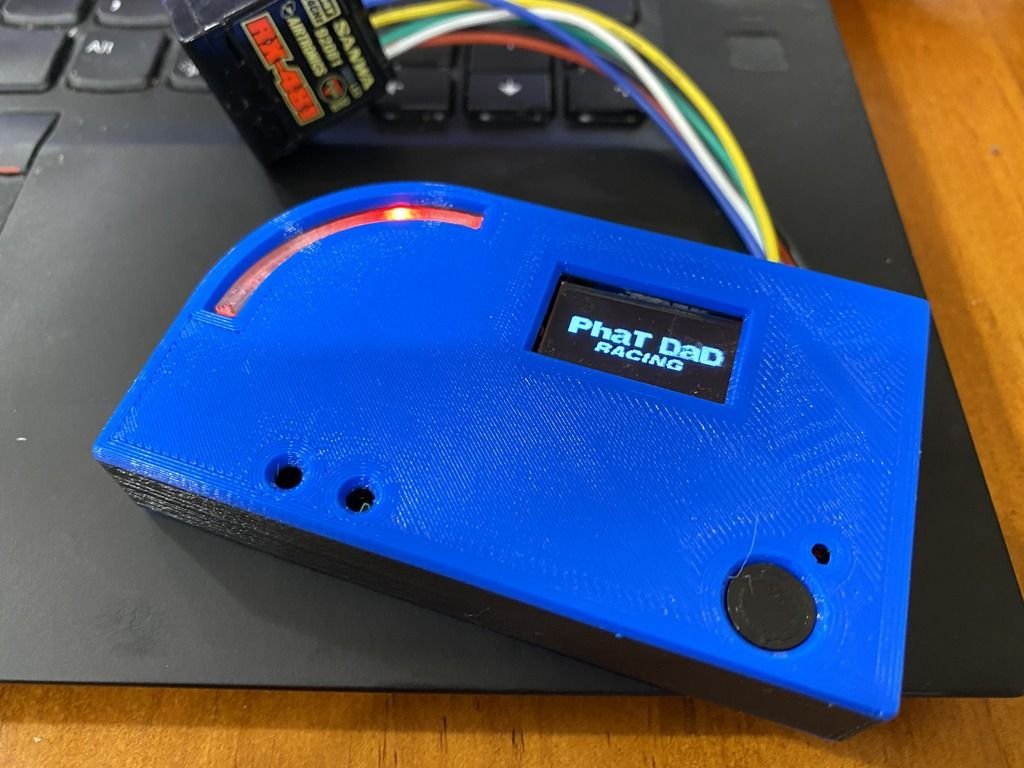

This a little project I'm working on - an RC receiver monitor using some custom electronics in a 3D printed case. The case itself is in two parts that snap together. There is also a translucent insert and a button that come off the printer. There are three bezels that will (eventually) be printed on my LCD/SLA printer.
The two main parts of the case have been printed in two colours, using a filament swap part-way into the print. See photo for assembled unit and short video that shows the parts coming together.

I am curious as to what information you gain from this? I have never heard of one of these before but would like to know more.

It's interesting, but probably pointless
It measures the pulse width and frame rate for up to four channels of an RC receiver. Possibly useful for checking that the radio & receiver are doing what you think they're doing, particularly with configurable frame rates common in modern radios. Is it really running in fast mode? Is it really centred?
I'm working on a new video with the near-final version, but here's one from the bench proof-of-concept:
I mostly design and build stuff for fun and to learn.
From a 3D printing perspective, my goal for this project was to have zero screws. So, the case is snap-together and the PCB snaps in too, using ridges on the inside of the case. The button and bezels are printed separately and clear resin seems to work ok as a light pipe for the surface mount LEDs.
