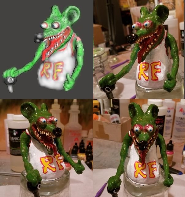

Currently printing while I'm at work. It was about half done when I left. Working on a special project for T-maxx body. Whipped up the sculpture in Meshmixer last night - first time actually trying to build a sculpted model like this from scratch in Meshmixer. Usually I make something in Blender in low poly then muck with it in Meshmixer.

Printed - not half bad for a shitty little DaVinci Jr printer. Was a pain getting the supports out of the teeth area, wound up snapping a few off. This print was of a version of the model that was slightly less detailed than the previous post, so a few things(pock marks, etc) are missing.
Test print.
Slathered on a coating of 2 part epoxy to get it ready for painting.
Prepped for painting.
I sent another out for production at a 3D hub, just to see if it prints any better, but I'm pretty pleased with how this one came out and will paint it up tonight.

Refined Rat Fink
Made some refinements to the rat fink mesh.
My question is, I'm having great difficulty with the supports. They are really tough to remove without destroying the print. I had farmed one out too, and that one came back perfect, but I'd really like to get my settings working correctly. I know I'm probably screwed because I'm using a Davinci Jr, but the prints looks great, just the supports are brutal to take out. Anyone have any tips for best settings for a complex mesh like this?
[edit] Figured it out, printing it lying on it's back uses very few supports in the mouth area where I had problems.

Im not a pro but you might want to look into getting your machine bridging better. Some combination of heat and fan that compromises strength but also gets definition. Small breezes made it tough for me until i put the machine in an enclosure. Pauses and print speed are part of the mix as well.

I don't print many complex parts but when I do supports I usually skip 2 layers on the z and a few more on the x/y to help get the supports off.

I was able to tweak settings and also get the best angle for the least amount of supports. This was so much easier to clean up, though both arms snapped and had to be glued back on, I attest that as much to my crappy little printer.
Printed and prepped for painting.
