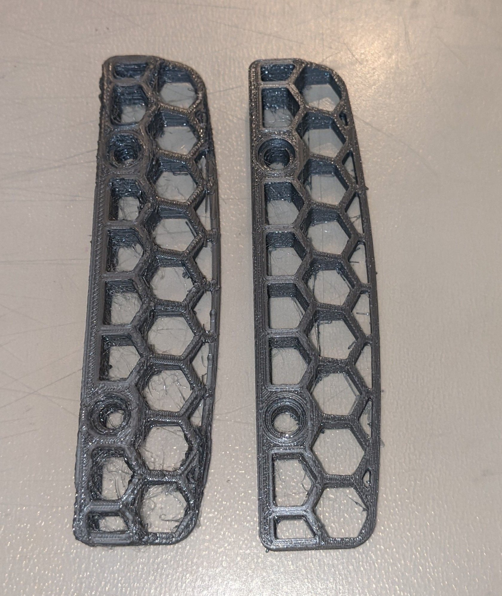

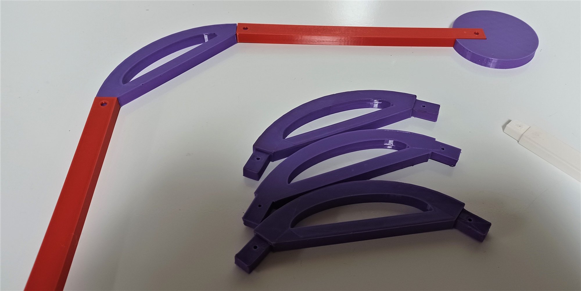

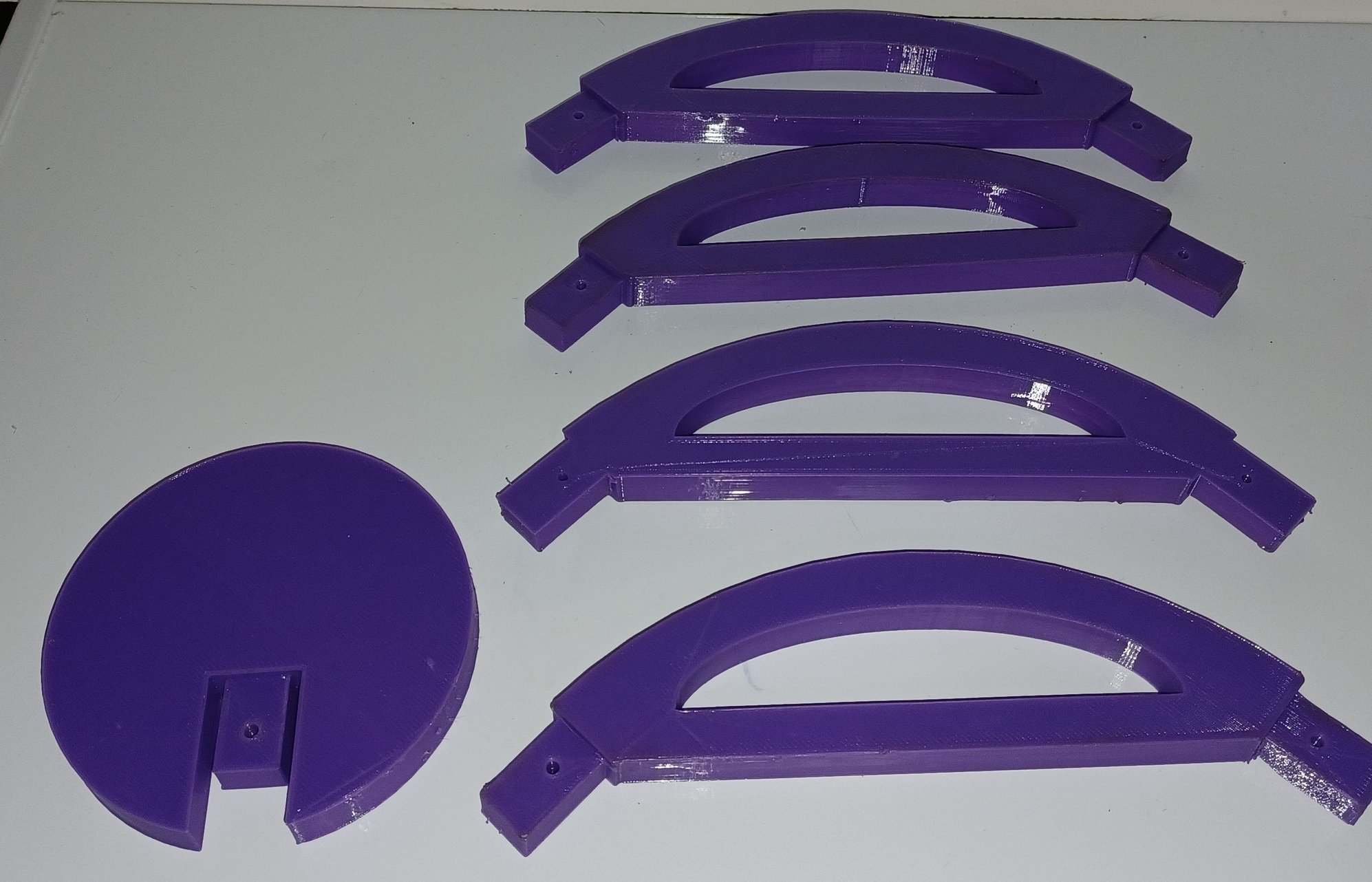

Heres my TPU adventures so far this week.. I designed some TPU corner borders and straight end "caps" for my basement track. .. only 2 walls, 2 tops , 2 bottoms and 10% infill so they are plenty impact absorbing.. I thought about doing the entire thing out of TPU borders, but I figure standard pla is fine for the straights..
two shoes likes this.

Your settings look dialed!
I'm making progress:
2wdMod likes this.

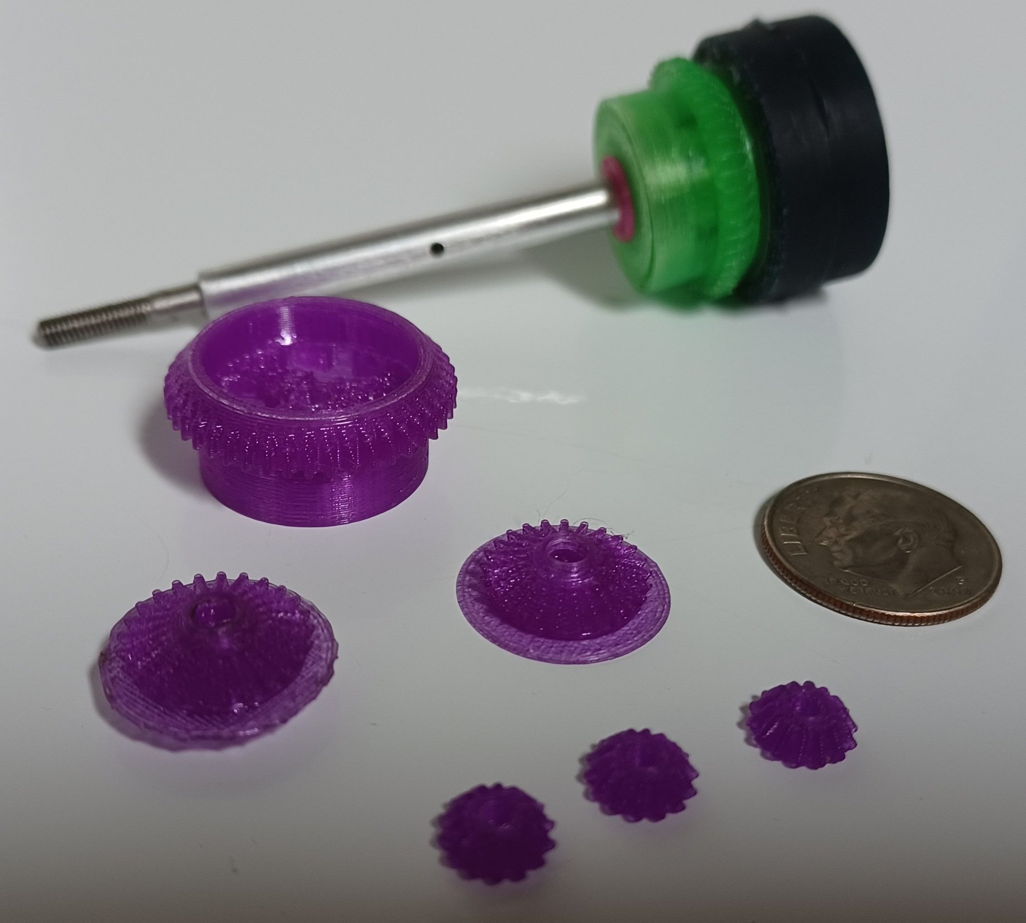

So today I found a really cool print in place differential model.. so I printed it out and the cage broke when trying to break the gears free, try 2 same result.. the cage was only about 2 mm as designed so we beefed things up to 3x5mm on the vertical portions of the cage. printed it out a few times after my fix and it breaks free great everytime without destroying the model!

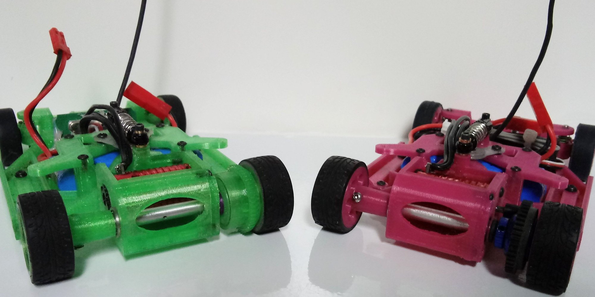

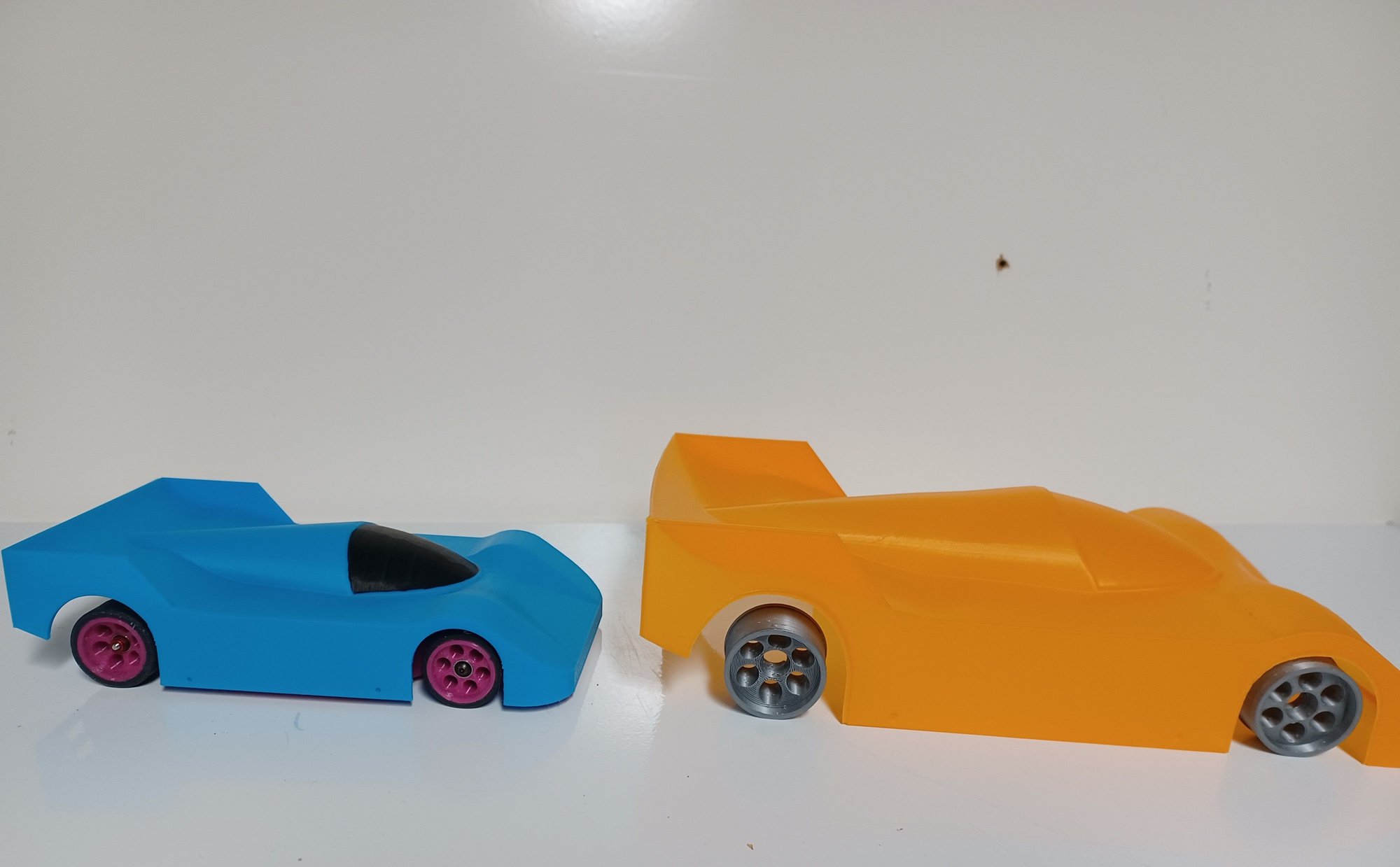

today I started scaling up components to make a 1/18 scale version of my 1/24 pan design..

YES! This is exactly what I've been thinking about - a small pan car that can fit a 270 or 380 sized motor. Hobbyking has a sensored 270 motor and Rocket RC makes a sensored 380 motor. I think either would be awesome in a small pan car. I can't wait to see more.

one of my favorite classes to race has always been 1/12.. so needless to say when the robitronics scalpel 1/18 came out I had to have one.. I loved that thing!! on 4cell I could run it in my basement, on 6 cell I could keep pace with 1/12 stock.. versatile size for sure.. thinking standard 2030 sized mini brushless on 1s for the basement duty, and 2s low kv, like 2500/ 3000, for track duty.

So I have been testing this prototype gear differential I designed.. This is for the 1/24 pan car and will be translated to the 1/18 pan car.. It functions nice at 1/24 scale .. Once again this is 1/24, not 1/28.. Diff gear is 44T mod .5 pitch.. The rear axle diameter is 3/16" OD and is constructed out of some 3/16 thick wall aluminum tubing which fits 3mm shoulder bolts with a fairly close slip fit.. Close enough that a thin layer of CA on a roughed up shoulder bolt with the head cut off and we have a rear axle that has 3mm threaded ends and smooth shoulder for moving parts to ride on the diff side and the axle "run-out" is very negligible to say the least if you use good quality machine bolts.. This is the same basic method I have been using to "widen" mini-Z ball diffs for all my 1/24 projects for quite a few years.. It works great and I have yet to have an issue with a sleeved and glued axle.. The planetary gear that drives the axle is pressed on using a spacer and nut to draw it into its press fit .. I also add a drop or 2 of CA after roughing the end of the tubing where its pressed into the planetary drive hub.. So far I have run about half a dozen batteries through this gear diff and its just getting smoother with every run as it wears in.. Total materials cost to build this rear axle was about $2.50 for the tubing , shoulder bolts and lock nuts, and 5 grams of plastic.. Also Not pictured is a printed left side drive hub ..

I'm going on day 3 of testing the printed gear diff and still going stroong.. After around 15-20 batteries through it its worn in smooth enough that I don't think it's going to get any better..
