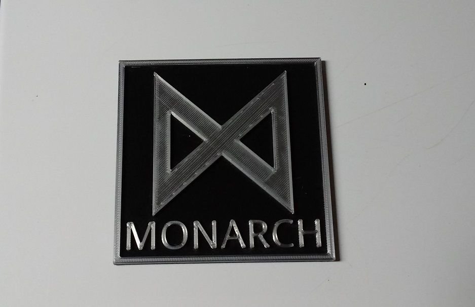

A "nerd badge" request from a a fellow comic book friend, so I designed it up .. The MONARCH insignia from the godzilla / king kong skull island movies..
of course it posted on my Thingiverse .. MONARCH Insignia by CSRC - Thingiverse

Super !

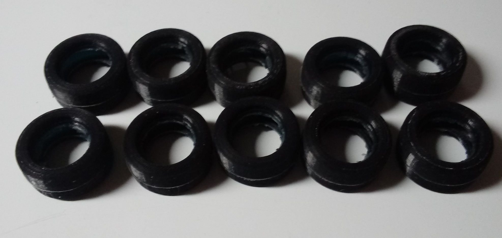

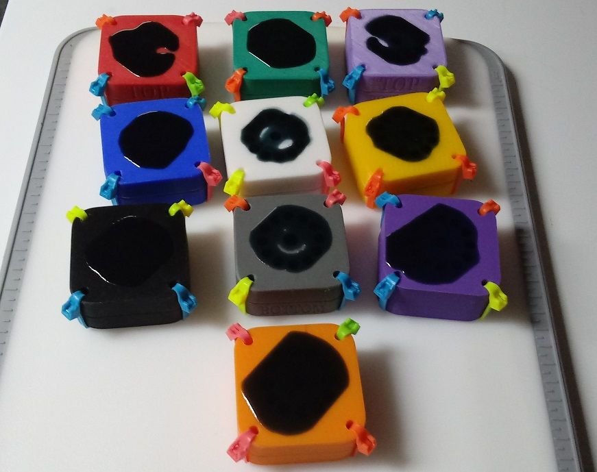

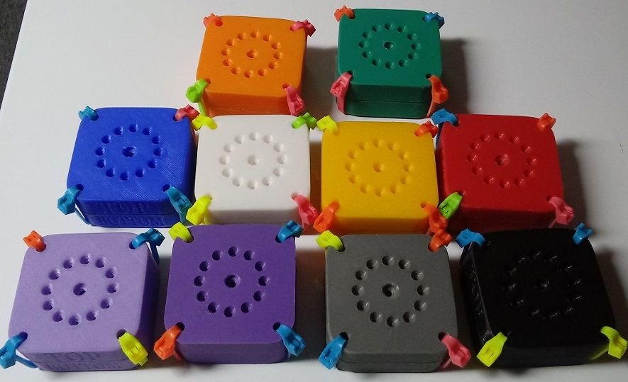

been busy for the last couple weeks designing, prototyping. and testing some tire molds for casting 1/24 silicone tires.. Each 3 piece mold takes about 9 hours of print time, and then about 2 hours of finish sanding time ..after the design was finalized I built up 10 mold sets so I can mold 5 pr of tires per shot.. I also built a vaccum chamber for degassing my silicone so I am getting 10/10 no bubbles in my tires..

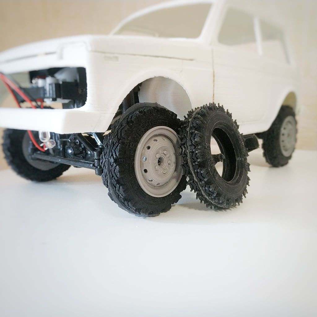

In exactly the same way I made tires for my Lada Niva

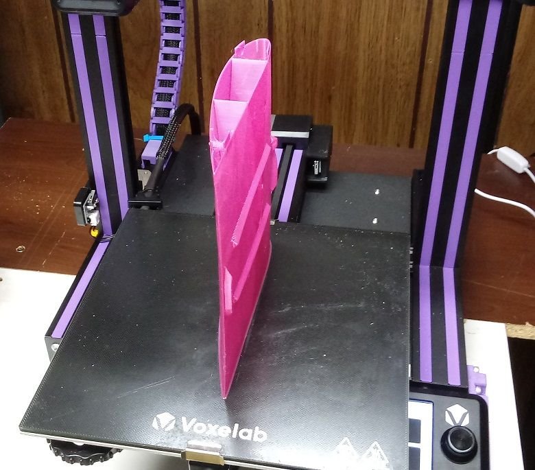

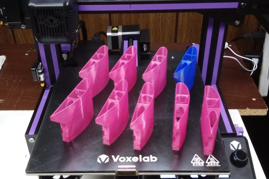

Been printing out airplane parts for a local who wants a printed plane but doesnt want to learn to do it himself.. Took like 9 runs on the test piece to get my profile dialed in for printing thin wall stuff on my new Voxelab Aquila printer, but the parts are coming off looking great!!
