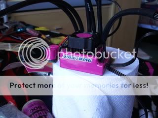

That is so true...we need PINK case for the HW esc....I m driving 2 Sakuras now, each for mod and stock class. I just ordered some Fluorescent PINK wires from Robobugs r/c. Anyway can you give me a link to where did you order yours from?
In the mean time here is what I did to my HW120 v2.1 while waiting for HW to make a PINK case esc.
Dudududududuuuuuu.....

Cherry2Blost, was goin to tell you about my friend here who has a pink HW esc but i didnt get the chance to show it to you and now he did!!!
