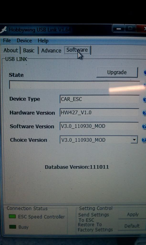

ok I installed the latest software , and i need help
I dont have any top end speed
everything else is good
running 10.5 motor open anything goes.
using hobbywing xerun 60a esc ,brand new foams , and used fdr from 7.8- 9.15 and no top speed at all. also its a 200 ft straight
any help thanks
by the way thanks for all the support hobbywing.

you using MOD software mate. change it to V3.0_110930_STOCK.

Ok, first as mentioned, switch to the 930STOCK software, that will give you all the tuning options. What motor are you running?
Next up, try out the following;
FDR; 7.1
DDRS; 9
Initial brake; Drag
Neutral range; 6%
Boost; 40
Turbo open time; 24
Turbo; 24
Turbo delay; 0.2s
Boost Start; 6,000 rpm
Boost ACC; 400 rpm/deg
Try that out, and I guarantee you'll have top end back. Make sure to temp your motor after the first few minutes though, to make sure you don't run into problems.
