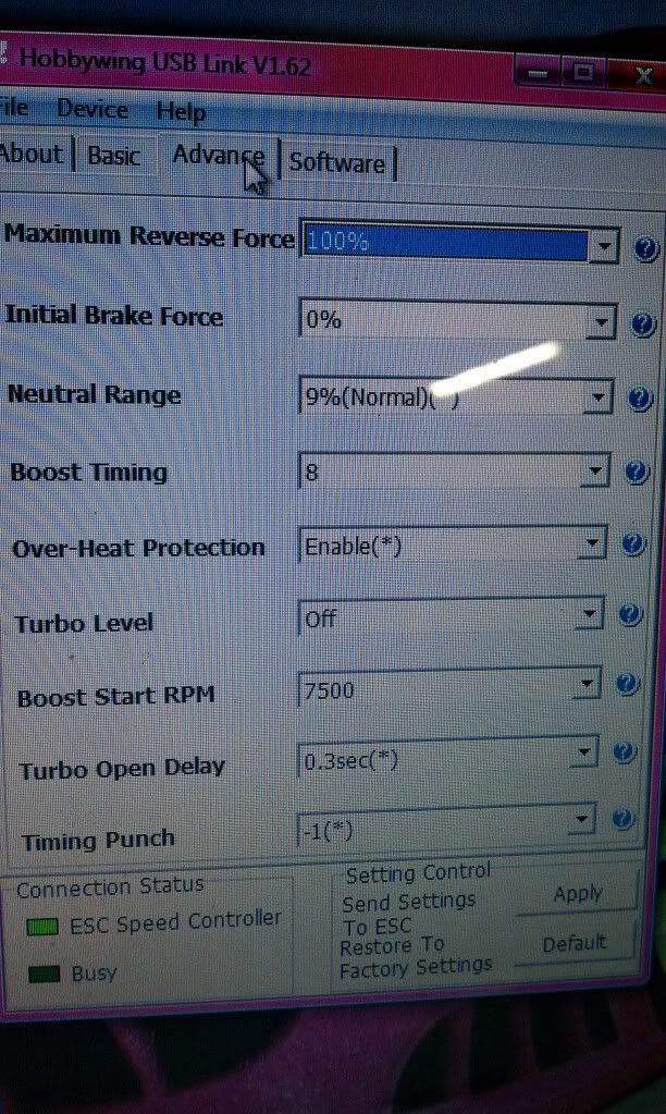

OK I searched a while back and been reading a lot of pages and can't seem to find my answer.I don'tknow how to tell if my Turbo kicks in. All I know is I need the latest software and the right gearing. The track I run at is asphalt, I run foams 37shore rear and 35shore front, 10.5 motor xerun. The straight is about 200ft or less turns are tight. My FDR is 6.8 on a tc5, I don't have my settings with me with, will add later. ?'s what settings for esc should I use for this track?
Here is a pic
Also I can't update the 2 in 1 box. Here is a pic
...BASHERS INC.....

Maybe its because you are using Hobbywing USB Link V1.62.
Try to get the latest program from here:
http://www.hobbywing.com/product_show.asp?id=218
Then first update your LCD program box by itself, then update your ESC. Remember to update the ESC program at least 2 times in a row. I prefer three times for less chances of error.

You will be alright with the 119 software, I ran these settings with a 10.5t:
7.5fdr
40 boost, 4k start rpm, 300acc, 24 turbo, 24 turbo ramp, delay off.
With a dualsky 10.5t.
It looks like you're trying to upgrade to an older firmware and it's not letting you.
You need to work with rollout instead of fdr when you are running foam tires.
