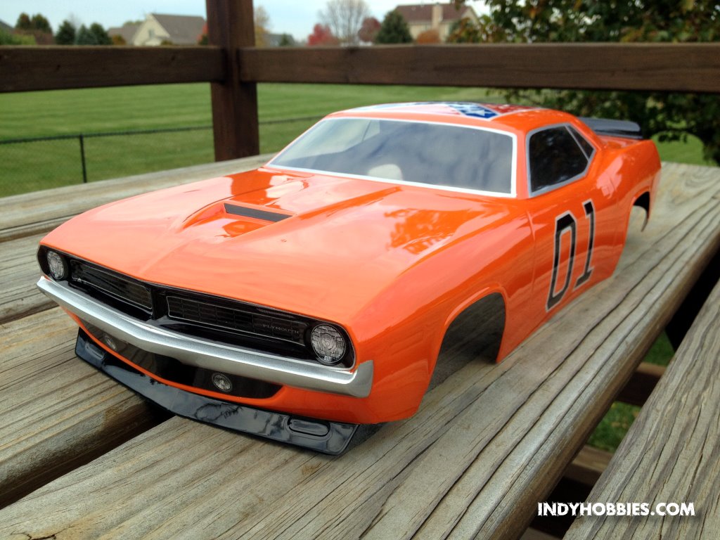

65 Mustang GT350 owners....Did paint your bumbers chrome/silver????
If so how did you do it??
And what paint did you use????

Yes I normally paint. The HPI stickers don't last, and look bad IMO even when applied carefully. I use liquid mask, then X-acto cutting with a bright light. I use Faskolor Chrome Silver. You can paint them from the outside if you are mostly building show car and use the spray mask that comes on the car. These were done from the inside.
