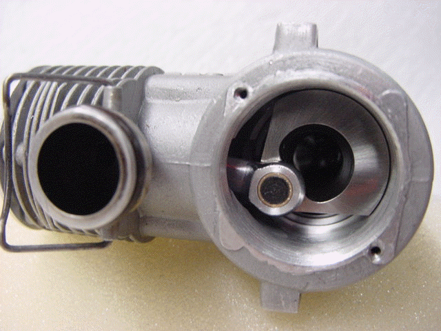

What are the advantages and disadvantages of full circular crank's counterbalance vs delta or semidelta shaped ones (RB).
At one point, and i think still, the MT12's and REX MR12 have full circular, and Novamegas up to the 2103 also.
Can you explain please???
AFM

Rotating mass!

Isn't only a matter of rotating mass... is a matter too of aerodinamics and the way the mix of air and fuel travels behind the crankshaft (that's why lately many crankshafts are cut with a very agressive ramps.

In my opinion not too much differnce, beside mixing ( which not realy proven yet). As long as it is balanced more or less close, the shape realy doesn't metter, that shape , which you see on the pic ( world champion in speed air modeling), of delta is done to create counter weight. Some people will talk about cranckcase volume, but it has been proven years ago, any cuts on web ( conter weight) don't make crancase volume bigger at all.
I preferd delta-it is asking less thikness of counterweight on opposite side of cranck pin area, which is realy realated to crancase volume.

Thanks, will experiment on the track with both types of crank on the same engine (exchanging), and post my "real world" results later.
