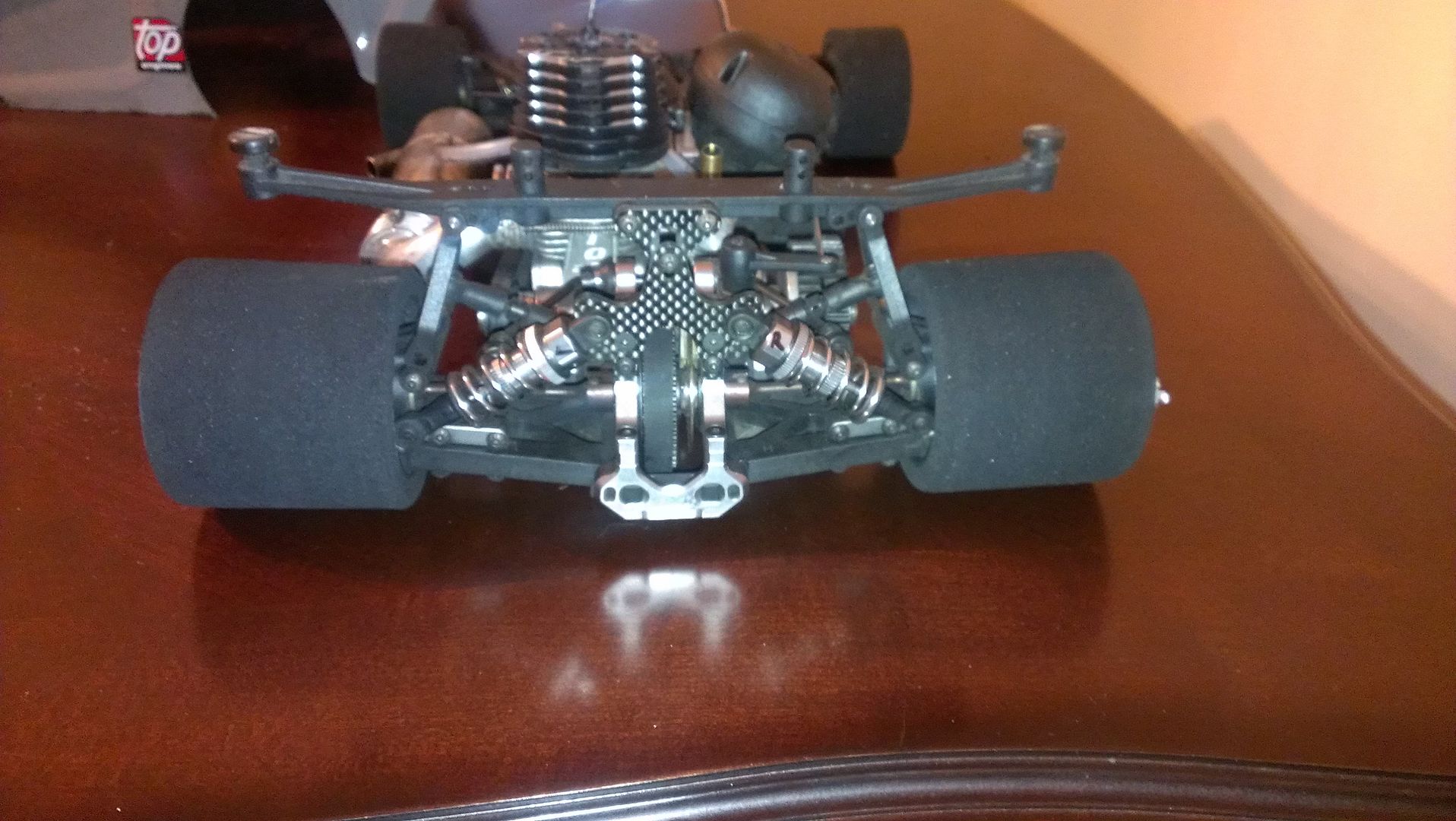

Post race tire wear:
I have no idea why the rear right wore more than the left, track has a huge right handed high speed sweeper
Front was perfect:
not as pretty as it was when i got there!!
Once i go over the car i will explain how the weekend went, it was interesting

Don't worry too much it's normal for the right to wear more than the left when you've got such a high speed right hander...

but it's a right sweeper-left should be more worn unless there are some sick left turns elsewhere on the track
Haha. Very true, it's been a long week lol!! Let's ask another question. What was the difference in wear L/R? How is the rest of the track? My point still remains though that it's not unusual for the tyres to wear uneven L/R depending on the track layout and rotation direction.
Swapping the tyres regularly will have them wearing evenly. I have noticed setups with different l/r chamber. I think this is a function of tyre wear too, that is if you get to much of a tapered tyre wear then you add a bit less chamber to that side. Can anyone confirm that this is how to set chamber on a 1/8?

Originally Posted by dan_vector View Post
But surely that would manifest in a car that was extremely difficult to drive? However Mantisworx mentioned that the car was good and he finished well placed so I doubt he had major chassis tweek or other setup issue?
Exactly!! car was a dream to drive, scaled to perfection, never wrecked and brand new! front tires wore almost perfectly flat and if you look closely at the rear pic the LR tire is actually larger/coned and the RR tire which is close to flat. The track had a sharp right turn entry into a large top speed gradual sweeper, into a sharp 180. It had a slight high speed push into the last 180 which didnt bother me and actually made it easier to go into it without having to use brakes. I am not familiar with this class or its tendencies and I am definately not complainig , just wondering if this is something typical or not. It was my first time racing this car and the class and brother I am HOOKED!!!
On a side note looking at the other cars post race their rear tires were coned pretty bad but i was faster so maybe i got something right
It was a 45min main and i did not change or rotate tires during the race, i also cut the tires down to 75/68 before the race. And ran 1 set of tires through all qualifiers and practice on saturday!

Marcus,
Its been a while, but I was experiencing the same type of tire wear when I was running the 966 at RCRCNT. I think I played with the length and mounting location of the rear upper suspension link and got the tires to do the accepted cone on both tires. I have to admit though, your car looked plenty "acceptable" to me during the main regardless of how the rear tires looked at the end.
