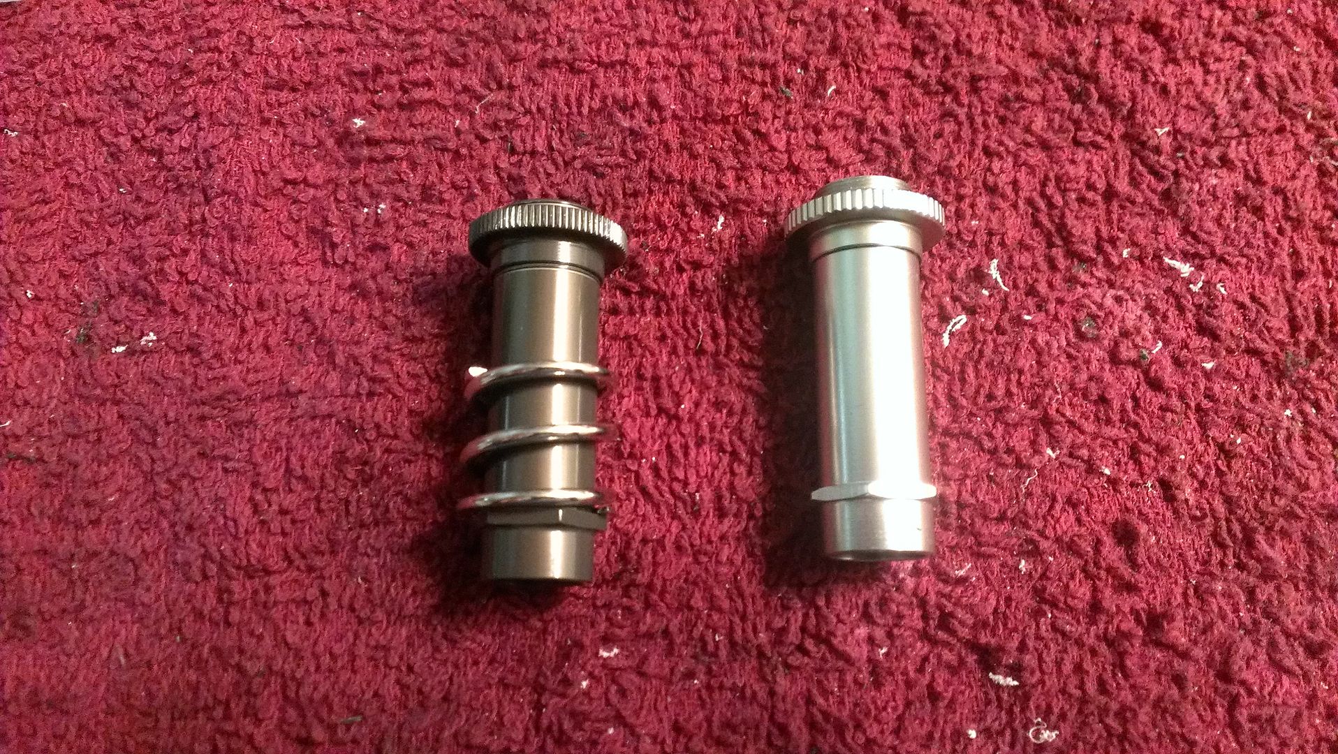

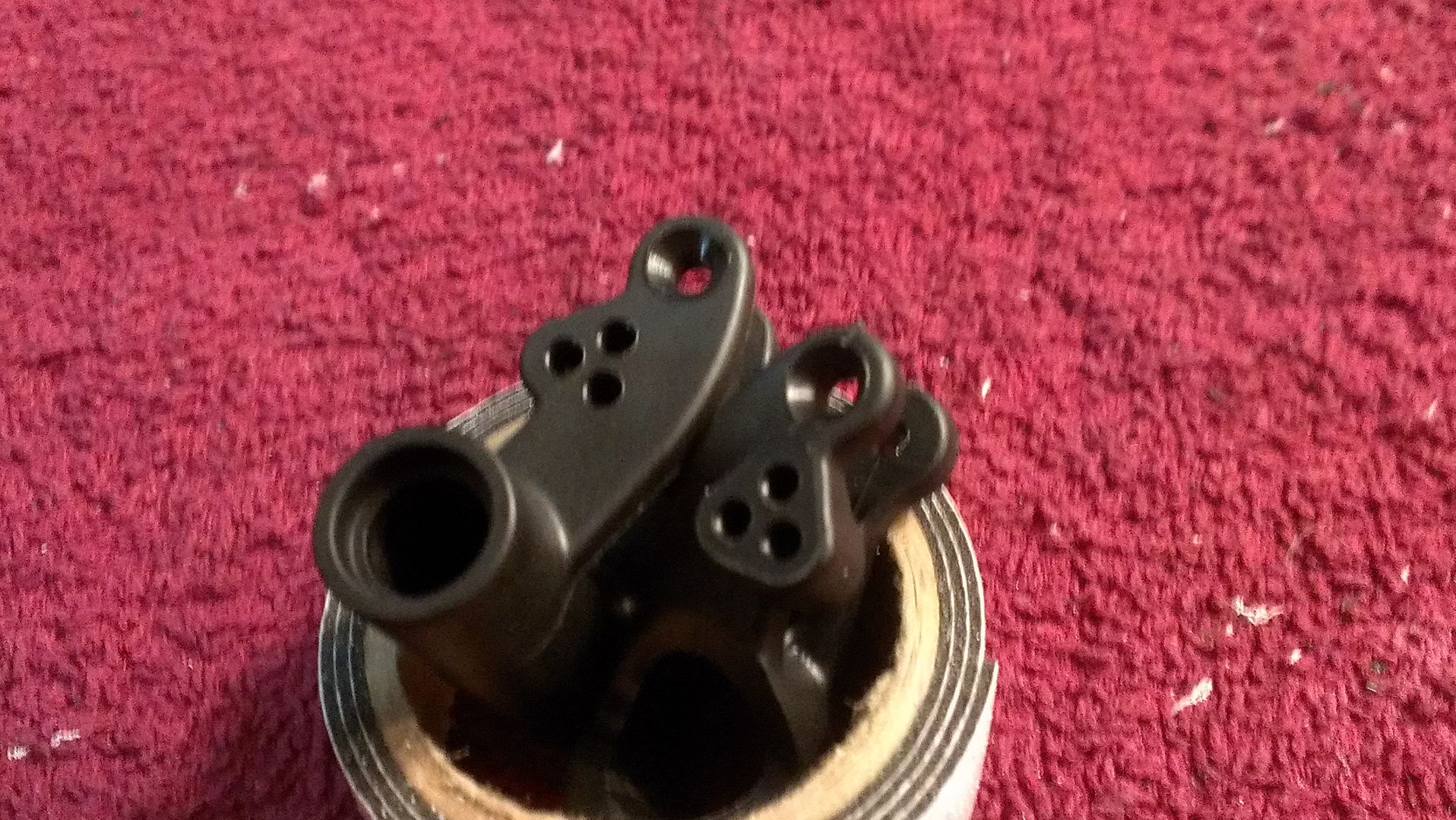

Its nice when the factory updates the parts, the new servo saver assembly is now hard anodized! new one is on the left and dont forget to use blue loctite on the threads, it will back off if you dont.

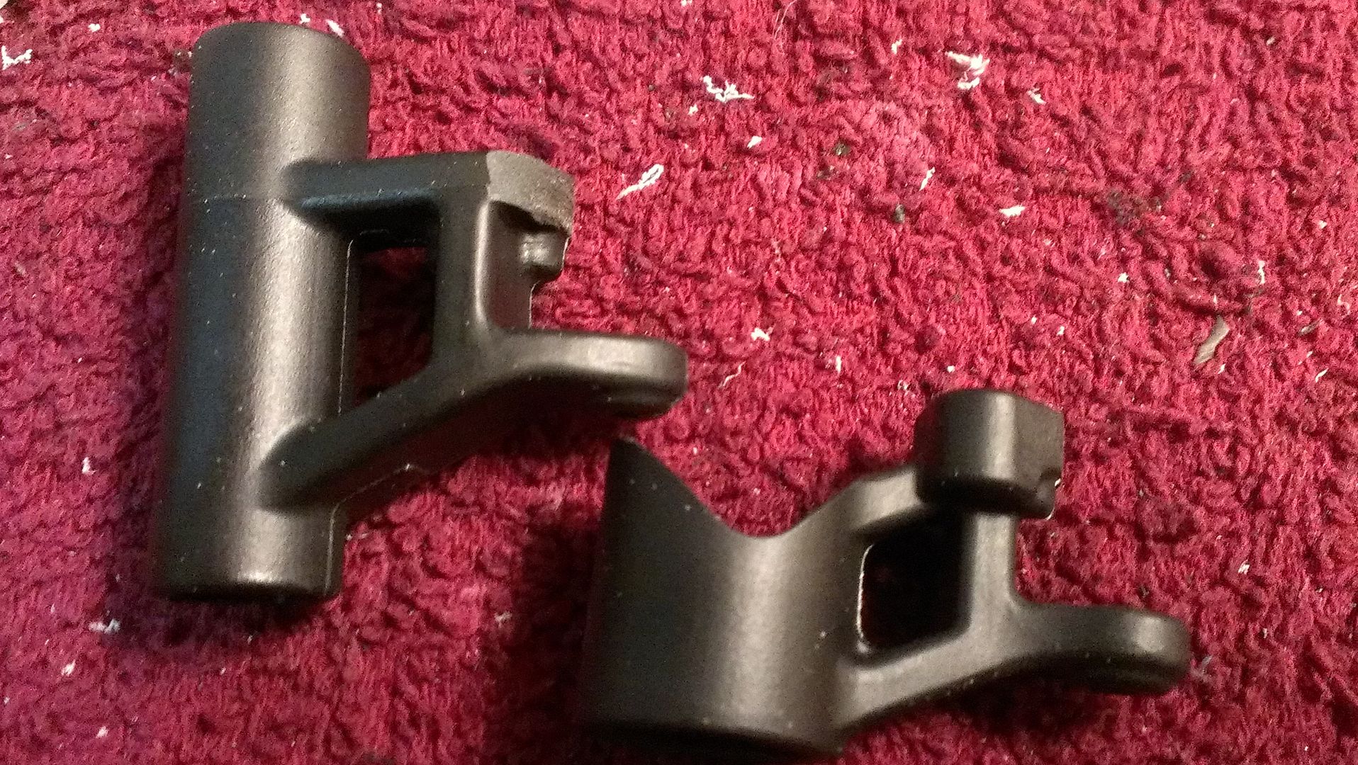

When the Ballbearing ackerman bar is released (next week) you will need to modify the steering arms by grinding off the upper portion to make clearance for the turnbuckles. since you are only grinding off the upper portion you can still use it as normal, if for any reaason you want to go back to stock settings.
before:
After:
Here is the complete assembly with the new bar:

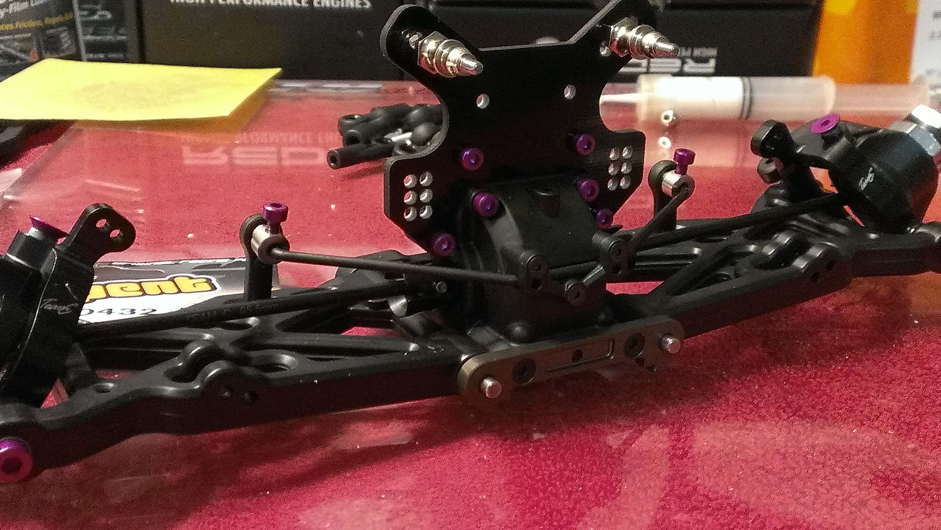

ON this pic you will notice a hole on the lower portion of the chassis brace, i drill the hole completely through the brace so that i can use a longer screw for less chance of stripping, the kit calls for a 12mm screw, i have a 15mm in it now. a 3/32 drill (.093") works perfect.

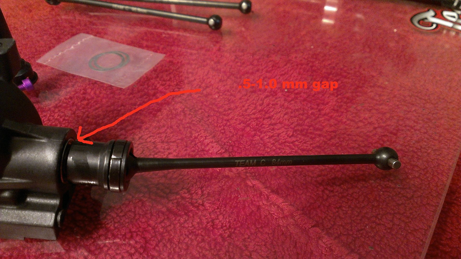

One of the things you wan t to make sure you do is not attach the center CVD too tight onto the housing the bearings need some wiggle room to compensate for the heat that is generated inside the box. Another note is that the factory now supplies the kits with 84mm shaft, they used to be 87mm but it would sometimes bind against the front of the transmission shaft.
you need to install 1 or 2 8x11x.2mm shims (Serpent part number 110432). you do not want it to be tight just take some space out.

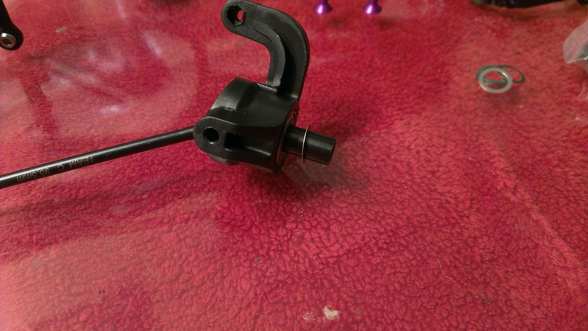

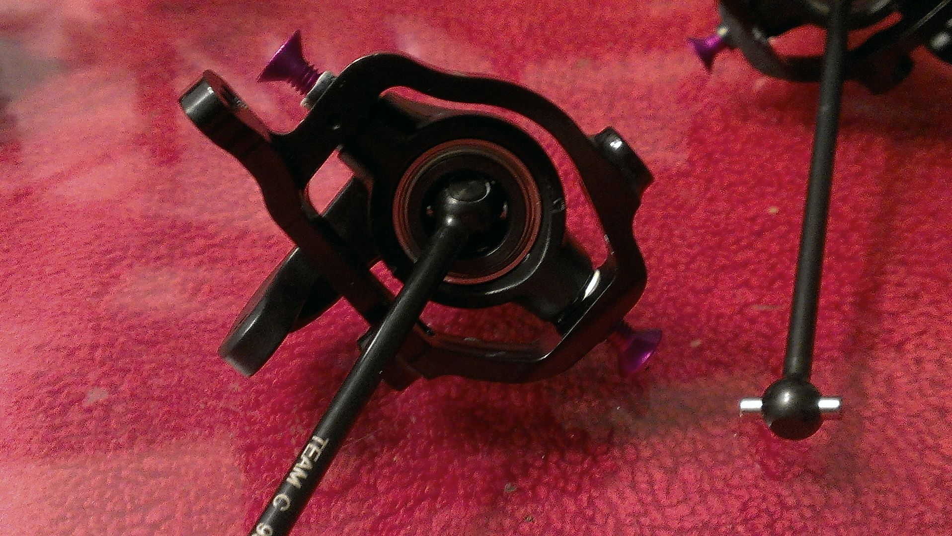

This is probably the worst area for play and here is why. you have the hat bushings that go inside the C hub holder, with a normal SHCS the tolerance between the OD of the screw and the ID of the bushing is loose so when the screws are tight there is no slop but since they are screwed into plastic they can and will loosen up adn this exposes the slop! By using a FH head screw the taper centers the bushing with the screw and eliminates that play, You need 4mmX14 FH screws to do this. If i would have found 4x16 FH i would have done this to the arm bushings to but since I am using the aluminum holders and loctite they will stay tight and have a minimal amount of slop.
