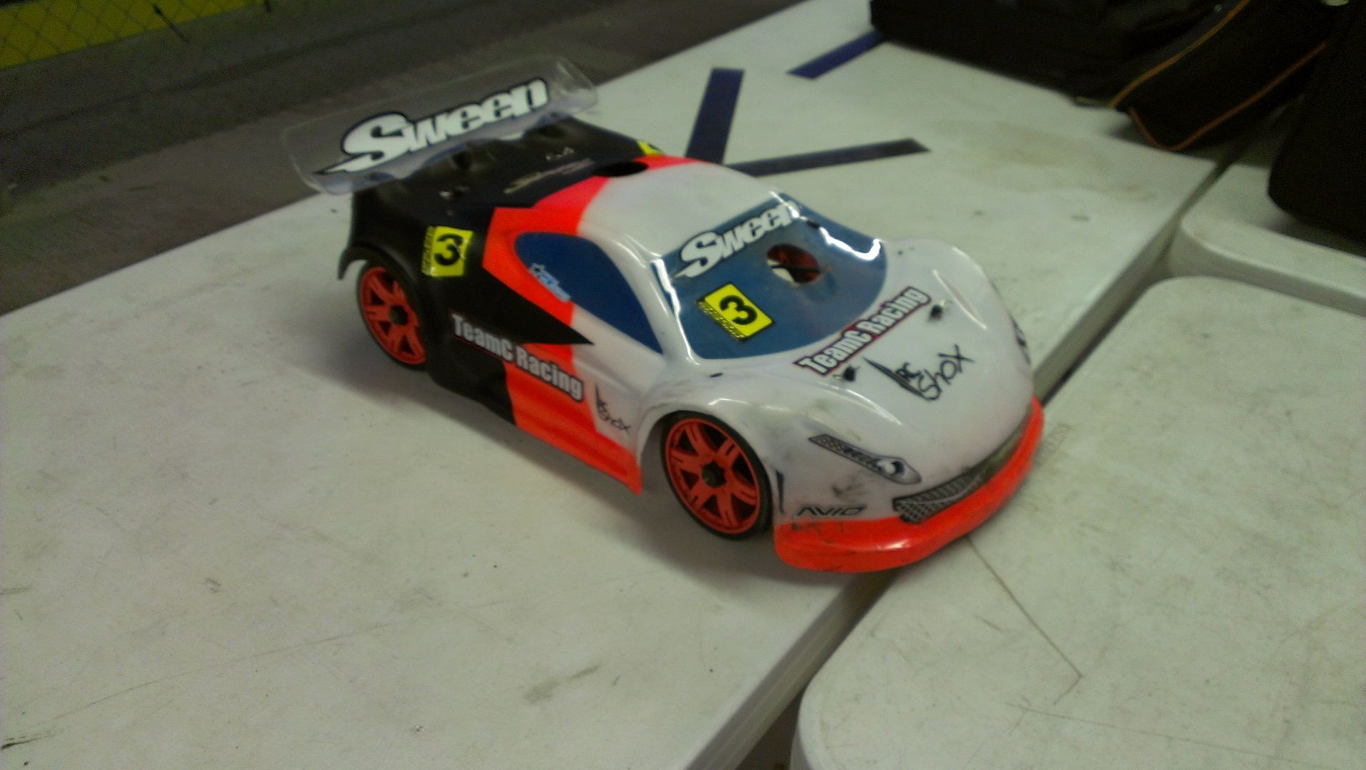

DOMINATE performance today with the TeamC car!! TQ every round and only one to run 16 laps!! car is amazing, hopefully i can keep it together in the 30min final tomorrow, 14 cars in the field so its going to be chaos!
First round i kept the car with posted setup above it felt pretty good but didnt quite have the initial turn in that i wanted, still had a pretty decent run even with the lap traffic.My Nove was acting strange during practice so i swapped to the XZR speed.....MONSTER POWER!!
Second round i changed front shock oil down to 1000CST and it helped but the was too hooked up and i couldnt get the car to rotate on exit still fastest but i knew i had more in it.
Third round i decided to go up one on both front and rear sway bars, and the car woke up!! could really drive out on exit and the car rotated beautifully. My brakes faded bad near the 3min mark and i had very little brakes. I really think i could go up on bars again but not sure if i want to risk it,see how i feel about it in the morning. I am getting around 10min of run time most are around 7ish , the mileage of the MERLIN fuel is insane there are three of us running the MERLIN stuff and all of us are very fast! P1/P2 and i think P3 maybe P4 are all running MERLIN advanced! I am the only TeamC here in a sea of Serpent!

Well luck was not on my side today!! car was better, i went to a larger rear sway bar and Sweep 45's. by lap 16 i already had a 10 second lead on second place ( almost half a track) and then a few laps after that i stripped second gear. In practice before the race i was able to run numerous low 18 second laps and was starting to get in that groove! it was pretty obvious that the car was good, every lap i was trying different lines and still pulling away!

Its there!! Now I can concentrate on the little things that need to be improved Stephen and Roy are backing me up so good things are on the way! The most noticeable improvement over the Cobra is exit grip especially on a loose track. Its almost impossible to spin this car around and if it does get loose you can drive out of it. I am actually sending some upgrade packages to Stephen for the european team! very soon the kits will also come with the upgraded one way bearings that are coming from my source direct so that will no longer be an issue. I havent had shift issues since before homestead
Anyone that is on the fence about this car , dont hesitate its the real deal! RCShox.com is going to begin stocking parts and kits here in about a week so parts availability will also be taken care of. RCShox will also be supplying shock pistons, arm braces and toe blocks!
