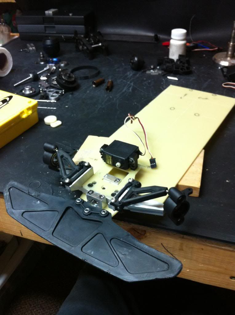

the front end is it just a teater totter? or is it supported by orings or anything?
is there something under your pivot point
...there is a 6mm pin that runs front to back which sits in bearings held by the pinch blocks..so yes..teeter totter I guess...Im going to run 2 screws up from the bottom of chassis to top
of servo plate with small springs (I think) on top captured by nuts...will allow
me to adjust teak side to side...damn I need a mill...

The new WRC is just like that (yours looks stronger), they appear to have built with the weight as center as they could and that's it. Set it up to try as is first. Teak doesn't appear to be a problem.
So stop crying and keep up the good work!
