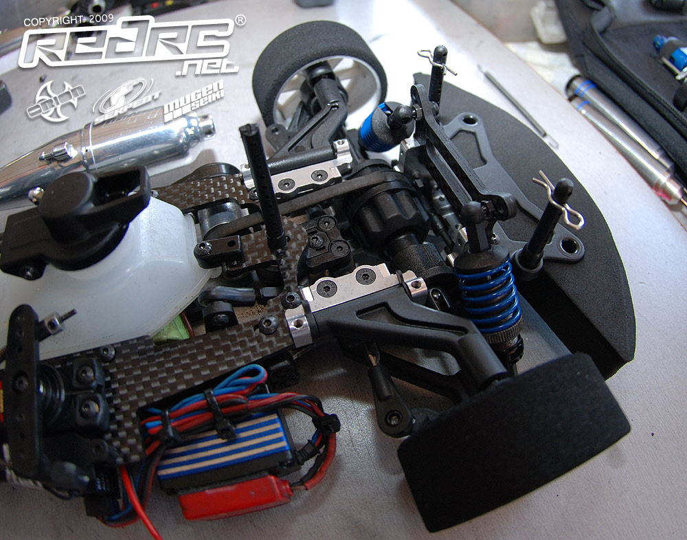

Another pic of the V10, from redrc.net

Is it me? or the front shocks are inverted?

Looks like it. By the way, it is not something new, we have seen rear shocks at the front, inverted, front springs rear, rear springs front ...

jelayne - Yes, I see that as well. They must not have recieved the production tanks in time.... That's a bummer as the production tank fits so much better in the car with lower cg and the fuel cap is much farther forward for easier refueling...
katze - Not even close...lol... The Xray is all plastic, this car is mainly aluminum. The shocks, brakes, arms, (production) tank, wheel axles, and many other things are completely different than an Xray. I think it's funny you give Hudy credit when the rest of the world slammed him when the NT1 came out saying it was a Mugen/Kyosho copy.... As far as the brakes, if they are too much then you can simply turn down the endpoint on the transmitter or simply trim the brake pad a little. With the material that Shepherd uses they work great and last a very long time so it's not a problem.
I'm not really sure why they would invert the front shocks. I also see they are using the 1/8 blue springs which are quite hard.... I wonder why?? The set-up I used was much, much softer on my car....

Mr cyrul, is that the correct position of the brake linkage, it looks to be detached from the rollbar.

For the shocks:
Daniele try a very flat Shock position, so it was easyer to turn the Shock as to cut something at the shocktower.
Hey Josh! these are not the blue V8 springs! I think these are the new Mugen springs, itīs from Danieleīs stock!

Hello Armin - Ahh, I understand about the springs now... I was thinking (are they crazy?!?!)...lol... I also understand about the upside down shocks - Instead of cutting the shock tower for clearance to lay the shocks down further, you just flipped it over and used a different ball end to allow for the clearance.... Interesting that he likes the shocks down so much as mine were in the 2nd from the outside hole here at Toledo and Cincinatti. Good luck this weekend!!

1evo - Yes, that is the correct position for the linkage. The roll bar has a few different holes thought it (at least the prototype that I have has 3) for the linkage alighnment. It doesn't have a little slider piece like the V8, this one is built into the roll bar.
