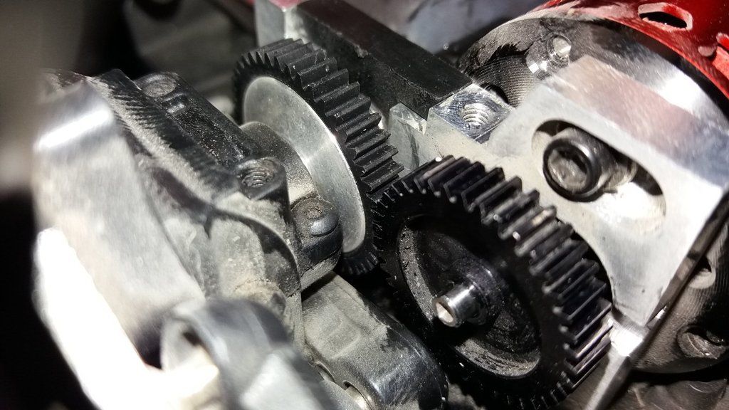

So i reached the first goal on that gearing: (31T/58T) with +100kmh with the 3450kv motor on 3s...
Also this platform is radical more stable then the buggy version.
Mainly because it's the wider and longer, and the eletronics are kept on very LCG.
I need to "underground" gearing now, for my kind of drving style...
-40T pinion and 45T spur. Ironically it's the smallest pinion i can fit with that spur now!!Errr, maybe a 37T if i had one!
I made a video with my cell phone with the spur mod...if the video has enough video quality i will post in soon on youtube.
I just can't wait now for testing it! But need a 4 pole motor. 2 Pole motors with this gearing is not going to happen, unless smoke is the goal! :P
Eletronics are for 1/10 4x4 buggys system's so on a 1/14 it's a walk in the park...perfectly doable and only me to test it! Ahahaha!

Originally Posted by Slap View Post
are those 32p gears ?
Nope! Just Traxxas 1/16 stuff on spur and Robinson Racing 48pitch on pinion....
I taked a nice pic, didn't i? :P
Oh Lord, save me from those "internet warriors" typing from mom's basement's... :P
lol sure did take a nice pic, im waiting on my motor mount to come in to start on mine was thinking of running them buggy tires but undecided on that yet
