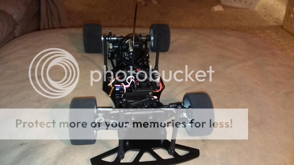

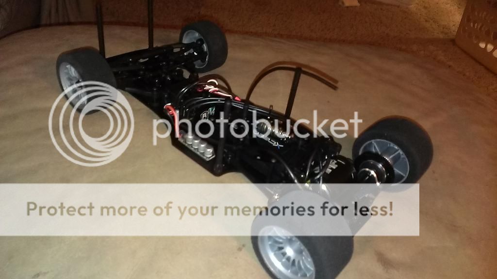

Very clean build john...any body on shots or is that not finished yet?

Nothing yet on the body. Its been completely cut out, but no paint yet. Right now the chassis has the ReventonS with the Stock 0 firmware and 21.5R and a 25 tooth pinion. I added the capacitor upgrade to the ESC. Radio setup is completed and it needs a trip to the tweak station.

You can't see it as everything is black, but with the shorty battery there is just over an inch of weight adjustment by sliding the battery front to back. I'm starting with battery back, weight distribution of about 40/60. With battery forward it's almost 50/50. So much tuning on this chassis.

liljohn...from the photos it looks like your side links are angled or offset f/r. Hard to tell exactly because everthing is dark colors, but if so, you may experience some erratic handling.
That's how I have been running mine as well after trying different things.

Originally Posted by burgboyz
Angled???
High bite? Low?
21.5?
More setup info please.
Hmmm...interesting....may have to try it I guess to see how it effects the car. Another reason why I like RcTech!
Hey Grasshopper...you have plenty to learn...LOL
SO far, all of the testing has been done and there are 3 ways to define these 3 setting...
(1) rear link TOE-IN (required the optional rear battery mount)....aggressive steering and overall performance, probably the best setting for carpet and outdoor but need to worry about traction rolling.
(2) Inside holes straight...default setting, more neutral overall. No more no less...
(3) TOE OUT setting...(front outside hole, rear inside hole)...delay steering and will prevent traction rolling, might need some fast servo to help to balance out the under steer. But this is the setting to go when traction comes up like in 3rd round of qualifier or main.
(4) Outside holes straight....(required the optional rear battery mount). Have not report and testing...but I would guess it is still neutral but with a little bit more turn in.
