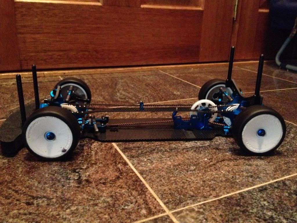

A solid day's work. Still a few days of work left installing electrics, putting it on a setup board, cutting/mounting/painting a shell, etc but the hard work is done.
Love that new steering setup Some other nice improvements over the V5.
Sorry 'bout the crappy pic, I'm tired.....
