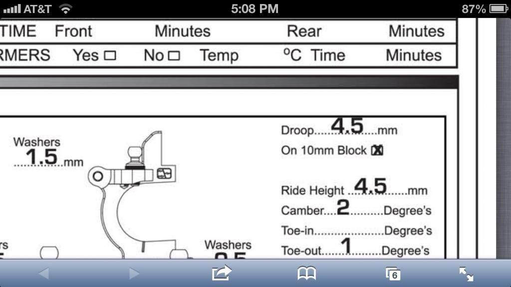

Hey guys, where is everyone measuring droop on the Evo in particular?? Under the arm, under the setscrew or the middle of the pin. On the standard asphalt setup it says 4.5 front and 3.5 rear for droop. Thanks
it is an uptravel measurement, how much the chassis moves from ride height to right before the wheels lift off
droop blocks reading (4.5) vs. uptravel (4.5) DOES not mean the same.

According to the setup sheet they are measuring droop under 10mm blocks. I just need to know where they are putting the gauge, under the arm, under the setscrew or measuring for the center of the hinge pin.
Hey Pete..
Depends on the driver writing the setup usually, however most use the point under the moulds where the shock ball stud is mounted when using the 10mm blocks. hope it helps ..!

Thanks Paul, that's what I was looking for.

Actually, I think most go from under the outer pin, I know thats where I measure from.
One thing to note is that the wishbone plastics are thinner on the new car, especially on the outer hinge pin locations (mostly due to the 2.5mm outer pins now used), and as such, need to be a little careful transferring droop settings from the Mi5 across.
Having checked it with the axle height method, 5.5 on the evo (by gauge, under the outer pin) is close to 5 on the old car.
HiH
