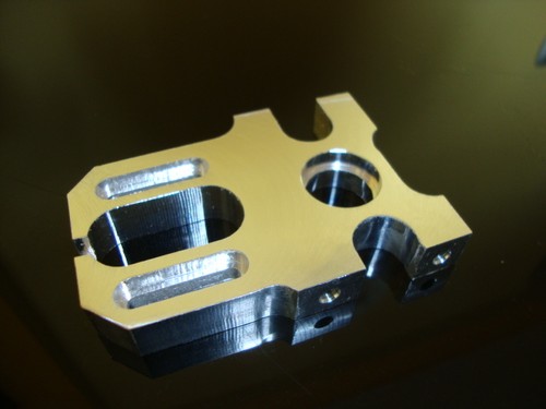

Hello yb2fast ,
This is the motor mount
Machined on high quality 7075 t6 alluminum.
i ll right send you infos with pm so you can buy the motor mount
The pinion gear is the traxxas #6493 34t .
http://brushlessmaniac.blogspot.gr/

Thank you Kostas..and thank you for the PM !!... I will be converting my GT2 Nitro very soon with your mount !
