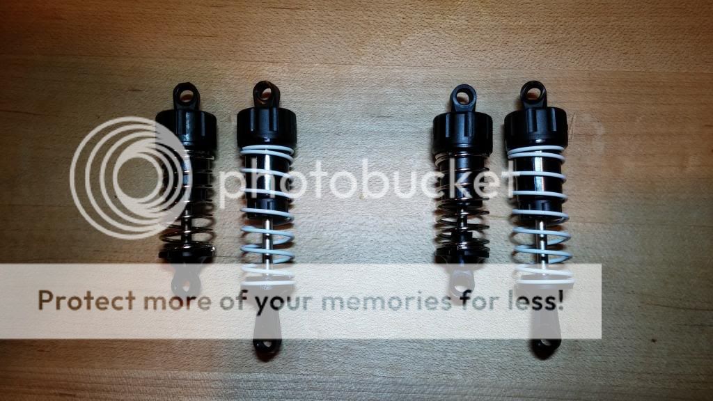

Angrymelon, after your build, can you post pics on the front suspension arms so I can see how it clears the suspension mounts?
My educated guess however is that the standard shocks with long ends will still have a taller ride height.
Here are some pictures of the arms, with the shocks installed. The front shocks have a 1mm spacer inside the body to reduce the length just a hair. This prevents the steering links from catching on the chassis.
Pretty much done with the actual build now. Need to figure out what electronics I'm going to put in this thing. Ordered up a Lancia body today, so I'll finally have one amongst all the Subarus!

Originally Posted by angrymelon View Post
I've not finished with the build yet, but I did get the shocks mounted and figured I'd take some ride height pictures with shell. This is without most of the electronics, it only had the silver can motor and a shorty pack I threw in there. This also doesn't have any pre-load spacers on the shocks. The body is sitting as low as it can go in the front, so they definitely cut it close. The bottom edge of the body follows nicely with the lower edge of the chassis. Depending on the body, little room for adjustment here Once the thing has some weight in it, I'm guessing I'll actually have to add some pre-load and raise it back up a bit.
Difference between front and rear shocks when compared to the DF03ra. I added 1mm spacers to the front shocks to prevent them from binding with the chassis. The instructions called for one that was nearly 3mm, which seemed excessive. No spacers are used in the rear.
Are these long dampers the same lenght and travel as the TRF 501 Front Big Bores?
http://www.rcmart.com/tamiya-54504-b...h=595_744_1011
Would you mind taking some pictures of the instructions manual, more especifically the dampers´ assembly part and also the parts listings at the end? I´m really curious about these long dampers and these higher susp towers. I tried looking for the pdf version of this manual, but apparently it was not released yet.
Thanks
Thanks
I'm not sure if they're the same. After looking at the link, it looks like those might be a tiny bit longer, and the shafts look like they're longer as well. I'll snap the pictures this weekend of the manual.

Thanks for the scans mate! I´m afraid that tamiya missed the ball this time and hadnt written the parts lenght in the manual. I still believe that those shafts, at least the rear ones are 40.7mm.
The problem with the dampers thing is that the only buggy dampers that are sold separately, that is, front and rear, are the big bore aerated trf. All the others come in set of 4, 2 huge rears and 2 shorter fronts and the set costs about 80 bucks! Other than that, they sell the C.V.A minis, which are buggy standard dampers, in different sizes, from 55 to 70 something, but they´re plastic and cant match the TRFs. So it makes a really difficult choice, not to mention the research!
I guess I´ll have to wait til the susp towers are out so I can get some measures and then wait a few months til the proper dampers arrive.
