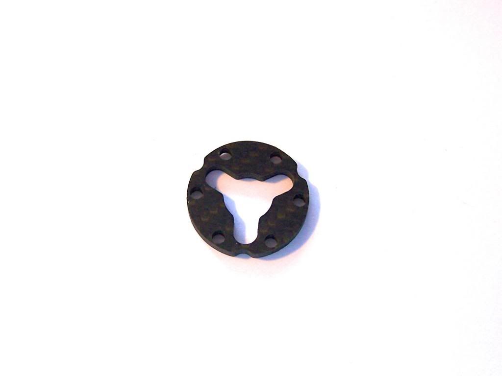

We've also designed a carbon fibre shim to move the motor outwards by 3mm.
The very centralized motormount of the T4 works great on carpet but during testing on asphalt we found the car could use a bit more chassis roll.
By moving the motor more towards the outside of the chassis the car will roll more and generate more traction and heat into the tires. This works exceptionally well when in cold conditions or when traction is low.
Can u post a pic with the shim mounted?
Hahaha , with all respect , who want to raise the shocks now all other lower theirs. I think that both Jurai and Martin Hudy have tried this , and didn't go that way because the lower shocks are the best way. Also with the Tamiya team on their 417. Waist of money.
Who want a carbon fibre plate between motor and mount? I would prefer it in alu to transfer the heat
