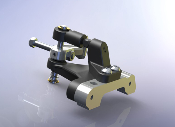

Full Luxury Front End
Is also mounted with 8-32 screws
But is aluminum, not plastic

I can't make the .gif work. I had a good one for that.
I always see that Speedmerchant front end and wonder what breaks first... the wheel? The chassis itself? Certainly not either the upper or lower arm. I've never seen one broken, then again most of the Speedmerchant laps I have watched were either RBF or Josh Cyrul, two guys who generally don't do a lot of durability testing.
The other thing I wonder is how much camber gain the Speedmerchant has in straight chassis flex.

wow what front is that ?!
I am giving the crc one last chance. Getting some new 8-32 screws, and will tap lower a arms prior to install. I just have issues where these come loose/strip during a run then I start getting odd behavior on the track, and scrubbing lots of speed (along with speed wobbles).

That's the speedmerchant newskool front end.
It's got to be the screws or something. I've never had to tap them and never had them strip or loosen up during a run.
