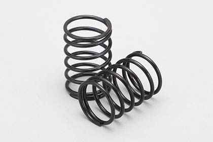

Anybody know the spring rate of the black springs that come in the RS kit compared to the regular bd7 springs

1.4mm wire x 6.5 coils
On paper that puts it between Black & Blue Pro Springs
Black: 6.0 coils/1.4mm wire 258 gF/mm (YS-1460L)
Blue: 5.75 coils/1.4mm wire 264 gF/mm (YS-14575L)
Yellow: 5.5 coils/1.4mm wire 280 gF/mm (YS-1455L)
Purple: 6.75 coils/1.5mm wire (YS-15675L)
Pink: 6.5 coils/1.5mm wire 290 gF/mm (YS-1565L)
Green: 6.25 coils/1.5mm wire303 gF/mm (YS-15625L)
Orange: 6.0 coils/1.5mm wire330 gF/mm (YS-1560L)
http://www.teamyokomo.com/partslist/..._ys_1465l.html
http://www.teamyokomo.com/partslist/...ys_14575l.html
http://www.teamyokomo.com/partslist/..._ys_1460l.html

The RS springs are softer than the black "white" springs. It even says so on the package.
Dave, did you do your math right? How is a 1.4x 6.5 coil (per your desc) stiffer than the black which is a 1.4x 6.0? 😜

oops
You are correct sir
