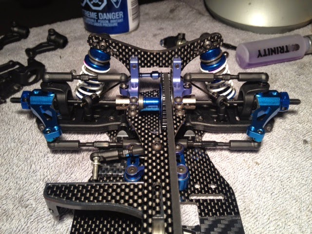

Here is what I'm working on for front durability.
Left side: xray arm, xray c-hub, xray lower collar and screw, yokomo top collar, yokomo CVD and steering knuckle. As you can see, geometry is very similar.
Right side: all yokomo.
Here is the full transplant.
5tylez is offline   Reply With Quote
I don't want to be mean, but i see a few things that are not at the right places, and you're basically setting yourself up for other problems. The turning point of the hub of the steering looks different, as well as the location of the lower shock point. If you wanted x-ray arms, why not sell the Yokomo and get the Xray.
Not to be mean - IMHO - switch back to Yokomo parts, trim the axles like everyone posted, make sure the bumper is protecting the front of the car, and you'll see it will not break.
Maybe so, but I'm gonna give it shot and decide for myself.
Id rather experiment than DNF.
Not to be mean either but why did you sell your BD7?
