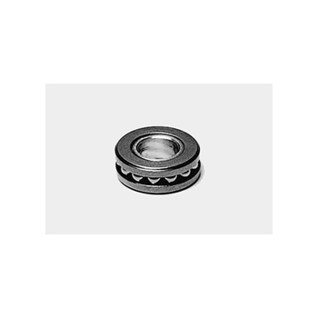

For anyone using Precision Racing System spurs, what size balls do I need?
Also, I don't know if this is right or not, but on corner exit I'm hearing the diff unload one tire (hear the motor rev up and back down). I've been setting the diffs pretty tight but still can't seem to get rid of this issue completely. I know I can't have total lockup but I feel it's costing me time out of the corners.

auto,
I had a similar instance with my diff. first make sure the conical washers are in the correct direction.
Then I found for me, I did not like the use of the ball bearing inside of the diff. I preferred to use the F103/F104 sandwich bearing

So that sandwich bearing replaces the conical washers, or the smaller bearing behind it?
My diff will be great for the first race, then after that it gets really loose even though the diff nut hasn't changed.

you still use the conical washers and all the original pieces. you just swap out the different style bearings.
It looks like a lot of people use this one piece bearing instead of ball bearing in F104 diff. Don't forget to put the washers like this )( ...different from the stock position with ball bearing.
WOW- that makes sense. Either I didn't read the instructions right or they dont explain that because I was having serious issues trying the thurst washer the other night. It was actually slipping like a slipper clutch. But it makes sense I didn't put the washers back in.
auto,
Amongst all the F104 variants with the "pro-style" diffs (i.e. the ones where the thrust bearing is located in the hub and NOT in the right-hand wheel), I have found that the standard setup of using a cartridge bearing to not be as smooth as using the thrust bearing pictured above. The main reason ball diffs feel "crunchy" is in the thrust bearing--and having a "vertical" cartridge bearing like in the "pro-style" diffs handle a lateral load makes the balls ride on a smaller surface area as compared to the properly designed thrust bearing above.
