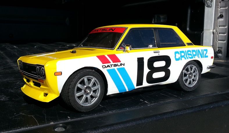

Originally Posted by .crispy View Post
I'm ready. Let's rock!
NICE!!!! But where is the driver figure? HAHAHA!!!! PS How did you keep the mirrors on or did you add those after it became a shelf queen? Those mirros were usually the first things to go on the scale mini coopers when they traction rolled.
These mini class racers got real popular in the DC metro area then just died away like most of on road racing in the Northeast (the two indoor carpet on-road tracks I raced at: The Track in MD and Debbies in Chesapeak VA are now both indoor dirt off road tracks). We were running those cars with 17.5 motors and the daring (not me) were using boosted ESCs. In Austin TX they were running the Cup Racers as a spec class with the brushed motor that came with it (I still have that motor and an ESC if that ever comes back - BTW that motor was used in other spec classes too). But if we were going to run these together with TRANS AM cars, which may be possible with today's lap counting software, I would suggest the 25.5 motor, same ESCs, and same battery. Not sure about the weight (is there space for enough lead to get the M class cars up to 1550 grams?) or the tires (I checked and the spec Trans Am and GT tires are too big to look scale). May be just put the 4.0 FDR limit in and run them as they weigh and with their tires. That way the trans AM cars will blow by in the straights and the small nimble M class cars will eat them up in the turns! What could be more realistic!
