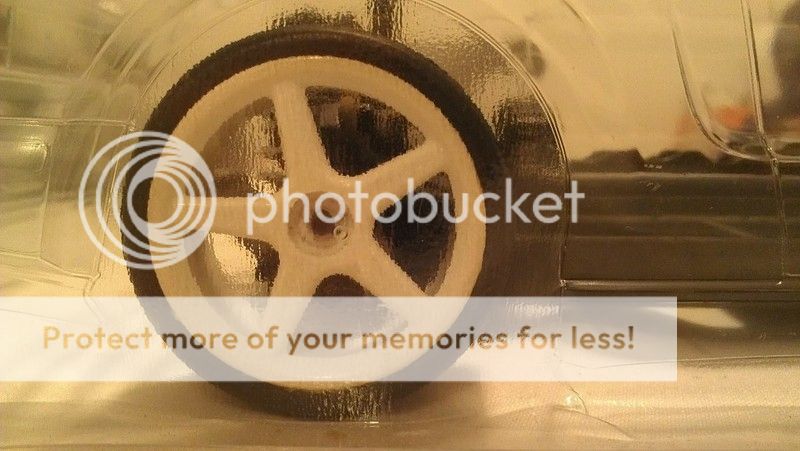

I finally got around to take some pictures of the problem I'm facing.
Front
Back
You can see in the picture that the rear is not centered at all in the wheel well. I realize this isn't a VTA body, but it is a 200mm HPI body.
Thanks again,
melon
P.S. For anyone who hasn't been reading the thread, that is a TC3 chassis I'm attempting to mount the body on.

that is a pretty minor difference.
your options include:
1) re-shim the suspension to have a shorter wheelbase (may have negative effects on handling, do you care?)
2) split the difference and call it good enough (you won't notice from 5 ft away let alone while driving the car)

You could always add more rear toe as well, that moves the tire forward
I would just ignore it because you are going to be tuning the car for different track layouts and may change toe, wheelbase etc anyway
