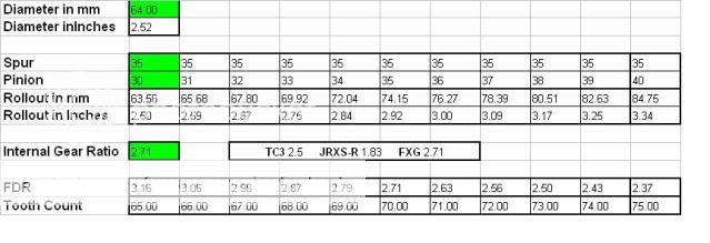

Originally Posted by liljohn1064 View Post
How this chart normally looks. The green boxes can be changed. The rest is locked, but update with the desired input.
This gearchart i super!
Is there anyway all we rctech'ers can convince you to make it public for download somewhere?
I know there is "apps" that deal with setup of Rc-cars is there one were the FGX FDR can be properly calculated? (android/ios)
Thanks for a super picture!
/Johnny, www.lajf.se
Its just my excel spreadsheet. If you want a copy, PM your email address. It also works when imported to any program that accepts .xml format. Took about an hour or two to create.

Default Add FGX Gear Ratio to GearIt app
If you use GearIt app on your iPhone or iPad.
Open the app.
Select: Add car
Car Name : 3Racing FGX
Transmission Ratio: 2.71
Select: Save
Hope this help
