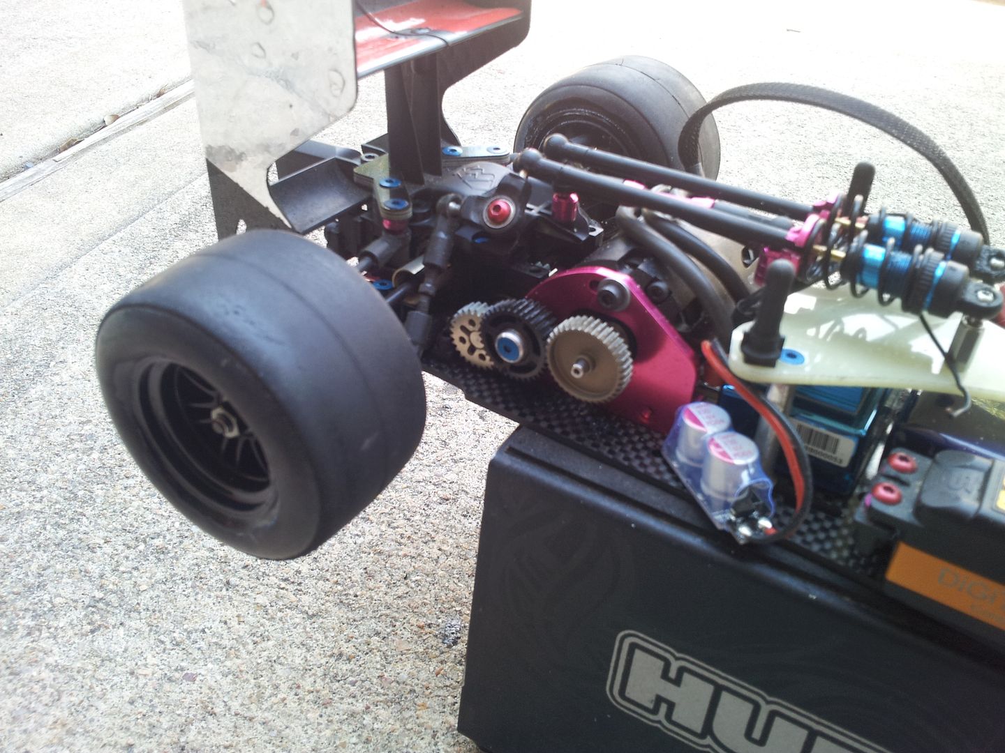

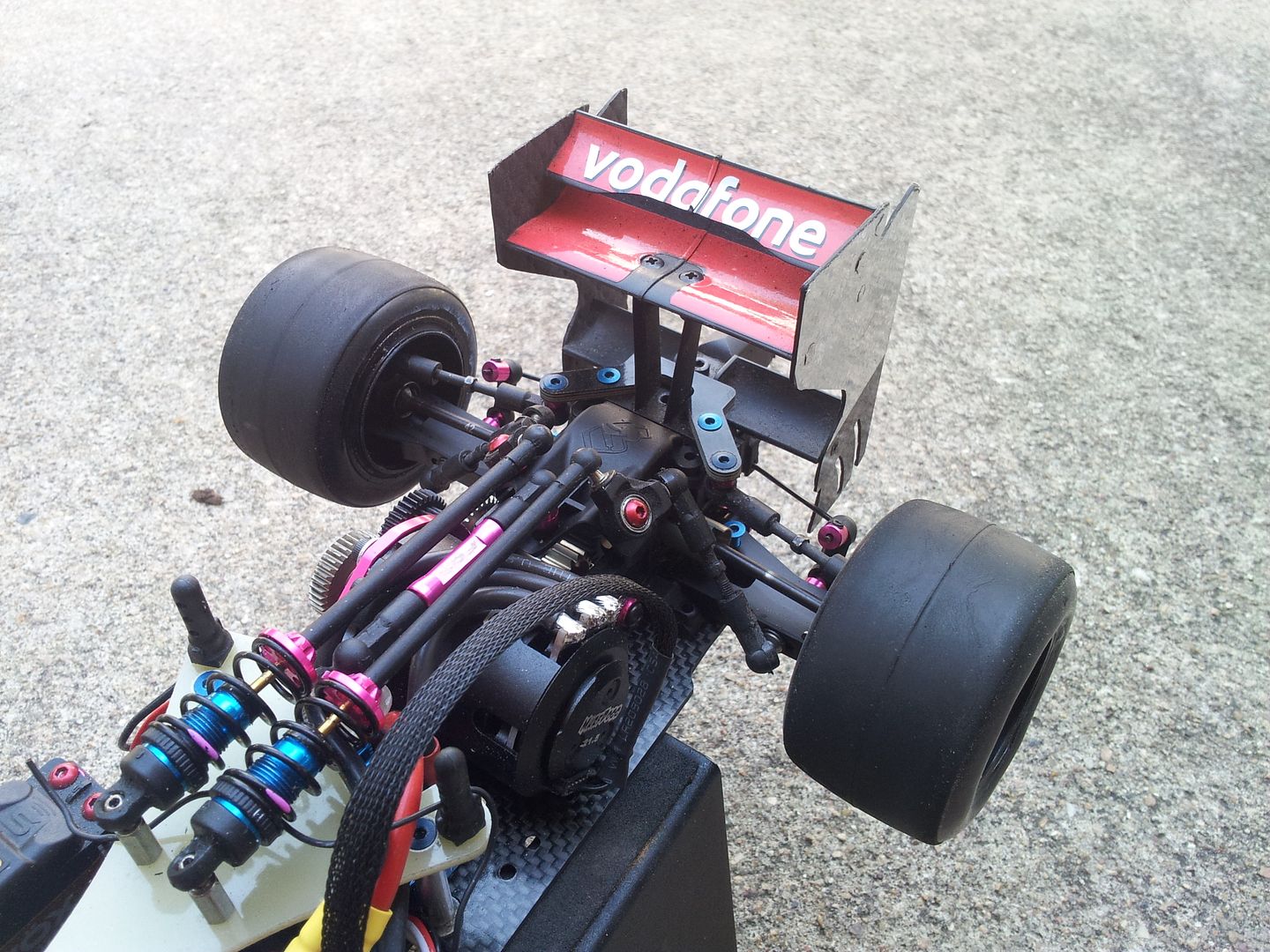

Ok guys, lots of development over the last few weeks!
The RCShox asphalt upper deck kit is complete and all of the local kits sold have been phenomenal! much better steering and more of it, increased corner speed .5 second avg quicker laptimes on the short tracks (11-13s laptimes) big track results are pending until tomorrow.
Our FGX ceramic bearing kits are also available now and are a steal at 55.00 for the complete set. I ultrasonic cleanse them and hand oil them so they are ready out of the bag!
http://rcshox.com/shoxshop/catalog/p...products_id=76
Now back to the FGX development! Since i started messing with the IFS I decided to only use the car for testing until i get it on par with the DD cars which are REALLY quick around here! I have been driving my newly acquired F104x1 that is very good. This helps me out because i know what i need to get out of my FGX. I switched the front damper/springs to a set of stock FGX shocks, and it felt much better, i was having really bad oversteer and the installation of these shocks and soft springs along with 3k oil/single 1.5mm hole pistons got the front really nice!
one thing that i noticed IMMEDIATELY with the IFS is that the front slop made it impossible to drive without darting everywhere so I converted to 104 knuckles and pit 0571 tires. I machined some extenders for the ackerman and will offer these on the website next week. I strongly suggest this mod! Also note the front sway bar.
The best tire combo is the PIT 0571/0572 these tires just work everywhere sooooooo....I figured out how to get the rears mounted!
Next hurdle was the strange Tweak i had that i just could not get rid of so i decided to completely rebuild the car using the 3r carbon chassis (which actually flexes more than the stock!!) and getting rid of the optional motor mount. After talking with Bremer he also had a strange tweak and he found out it was the motor mount where the side screws attached to the main plate. Rather than fight it i just went back to the stock mount. i also replaced the gears with the aluminum 3r units and Exotech rear arms (nice work Mike!)
During the rebuild i decided to go as light as i can with everything so all of the screws are aluminum and i deleted anything that was not needed and went to a smaller battery. i think the combo of extra gears and weight is wreaking havoc on acceleration and heat. On this subject i have been having a hard time finding a good motor for this chassis, they all work but around here we are running 2.0/2.2 FDR on DD!! 2.4 is all we can get on the FGX so we basically need a ultra high TQ motor with some decent RPM's So far the Murfdogg is a freakin spark plug!! very powerfull motor, stays cool and with a 36t on it right now has plenty of top speed with temps only around 130* with zero timing so i have some room to play!
CHASSIS DYNAMICS
Well now that we have front and rear roll centers to play with I think i have it figured out, at least close. The stock rear link setup keeps the chassis flat so it is somewhat matched with the kingpin front but now since I can change the front roll center i needed to come up with something for the rear. I first tried just a link from the hub to the rear of the bulkhead and it had so much roll that it would actually scrape the sides of the chassis with 7mm ride height! I want mech grip but not that much so I made a piece that gave me a shorter link and much better geometry.
Rght now with the stiffest springs in the rear it feels like i still need a thicker sway bar (#4 is already in use) and stiffer springs. Tomorrow will be a true test, track is already prepped with 200lbs of powdered sugar so the DD cars will be fast!
MantisWorx is offline   Reply With Quote

Almost forgot!! I am using the ball dif now, i figured out that the thrust bearing has to go on a certain way, if you install it backwards it feels horrible. Also went with 12 carbide balls instead of 6 ceramic. It feels butta smooth now. The leaking gear dif was getting on my nerves....
