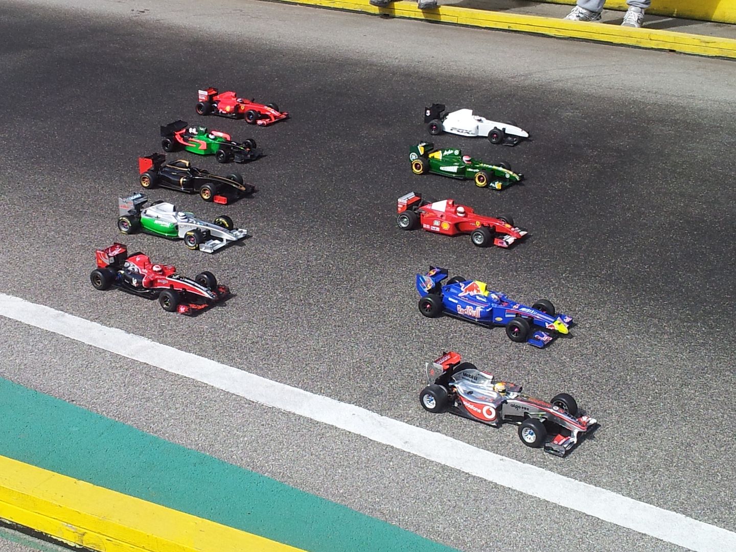

cool little vid of my Redbull from the race yesterday, its a big track so its hard to get closeups but neat none the less!!
http://www.youtube.com/watch?v=bt4rwwqTjSE

This is a great video, especially the sound effects that comes with it!! Are all the cars on the Track FGX?
Lookin right now for an F1. Not decided yet, the F104w or the 3racing FGX? The F1 has to be finished for the outdoor season!!
Having read this thread. It's not crystal clear to me about the mentioned issues in this thread. Maybe I'm totally wrong but imo the main issues are the steering and motor fitting issues. Are these issues been solved with an upgraded version of the FGX???

Most of them are FGX's three are 104's. Motor fitting issue is not that big of a deal. just need to do some dremel work and move the battery post. I never remove my battery so im not concerned about the battery door. My biggest grip is the front end slop, I managed to get most of it out but still needs more shimming. Also on asphalt outdoors the only thing we are breaking is kingpins, nobody has broken any arms and only one topdeck failure and he hit the wall HARD!
