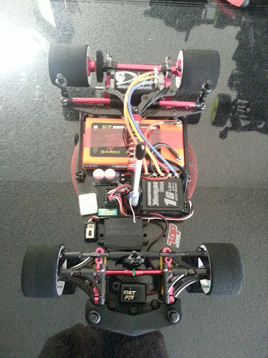

Hi Guys,
A few weeks ago I made some changes to my Rebel 12 car.
Changed the steering with a middle servo horn. All parts used are original T.O.P. racing parts!
Attached you will find a picture. Drove with it, the last 2 races, and it works perfectly.

hey
have made ​​myself, or come by the Racing TOP

Nice job with the Sabre parts ;- )
On my Sabre I never understood why this steering bellcrank doesn't form a right angle. I mean the angle between the arm linked to the servo and the arm where the steering links are attached. It seem like it creates an asymmetric steering. I still have to play a little with the servo linkage and servo placement but I'm seriously contemplating cutting a new CF plate with a right angle.

It looks like you just need to shim the ball stud on the servo saver to get the angle right to the crank arm.

nah, I suppose you are talking about the angle of the rods viewed from the sides of from the front/back.
I was talking about the angle "built in" the CF part, viewed from above. It's more of a 80 degree angle than a 90 degree angle. I never measured it but it's quite visible even on the picture above.
