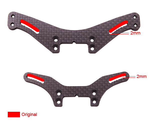

If you like your car to feel free and aggressive through corners, the lowered towers are something you might like. It moves the piston of the shock further up into the shock body. This reduces the volume of oil on top of the piston, thus reducing pack. That pack makes the car feel really stuck and stable. When you reduce that pack, it makes the rotate more aggressively, at the expense of stability.
Hope that helps some!
-Korey

But why this change is often below 2 mm?
Here is the quote from Hi-LowBlow
Originally Posted by Hi-LowBlow View Post
Actually, it will change the piston position in the shock body. When the 2mm lower shock mounting holes were used, the piston position will be 2mm higher that will generate less pack in the shock. It frees up the car a lot.
Hope it helps.
You can check the link: http://www.tqrcracing.com/shop/produ....asp?p_id=1872
TQ RC RACING

I'm using him, and as said Korey, increase in the response of the model in curve and the small shock pack decreases the overheating of tires, great in hot weather, the originals are still good in the cold season and when you want more grip.
