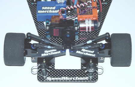

Originally posted by Geek
If this was patented a year ago.. is it available?
Does it fit on a CRC 3.2?
Just recieved an e-mail from speedmerchant and there reply was this is not yet available because of machine shop vendor problems but will hopefully be available to public in spring.

I like the look of that front end, looks like it would be very strong as well...

I dont have much time now, so just a few quick things
Spyderx- I attest! lol, and his car was alot better.
The v-force is by far the most adjustable front end out there, it will be worth the wait.
Sorry, Storm, but I am going to disagree. This suspension does not have adjustment to camber gain. It also does not have adjustment to roll center. You can adjust camber, caster, springs, ride height, and that is about it.
Don't forget that I ran this suspension in development. It pushed like a dump truck out of the box. I suggested the in-line front axles to get it to enter the corner better. That helped, but didn't solve the overall problem. It has too much camber gain when the outside wheel is under the load of a turn. That disrupts the tire patch and there isn't enough traction to turn the car.
Another point is that the spring position is at a location where the K-factor of the available springs does not support the car. The ratio is 1.75 to 1. And since the springs are too soft, that means more chassis dip to the outside and more camber gain that upsets the wheel patch.
Bottom line is that more development is required.

DavidL- I remember you Eric and Bruce having a fun time last year with that,lol. I got the chance to try one out at the end of last season, and agree with you about the development, however with a few changes it could be extremely adjustable, and you can adjust droop too in the version i tried.
