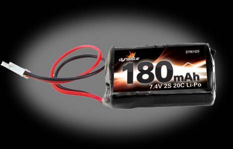

Now I do have the receiver pack one dynamite 180mAh 2s 20c 7.4v and Protek RC LiFe 6.6v 200mAh. Do you need special charger to charge LiFe packs?

Thanks for the help guys! I think rather then buying a whole new charger I will just pick up a booster. Or if I find my ideal esc eliminate it altogether.

dynamite 180mAh 2s 20c 7.4v (actually a battery used for losi mini's)

Just to be clear, that battery would be fantastic to run to power the esc/receiver/servo, however to power the motor you will want to use a 3.7 lipo designed for use in 12th.
wrong, the battery will work very well in a 12th car. Maybe the runntime is a bit short with a 1800mAh pack. You better go with 2000-2500mAh.
A 2S A123 LiFe pack (2300mAh) works also, but needs more room.
180<1800

Originally Posted by andrewdoherty View Post
180<1800
Perfect rx pack!
It's in two of my cars!

Originally Posted by CypressMidWest View Post
Perfect rx pack!
with the 7+ volts, are you using something to reduce the voltage?
i am aware that KO electronics are happy with 2s lipo receiver voltage, but Tekin specifically discouraged it. has this situation changed?
Tony Shimko
avs is offline   Reply With Quote
Old 02-17-2011, 06:25 AM   #35459
theisgroup's Avatar
Join Date: Apr 2002
Posts: 3,191
you must drop voltage on the tekin. but a couple of diode will do the trick
