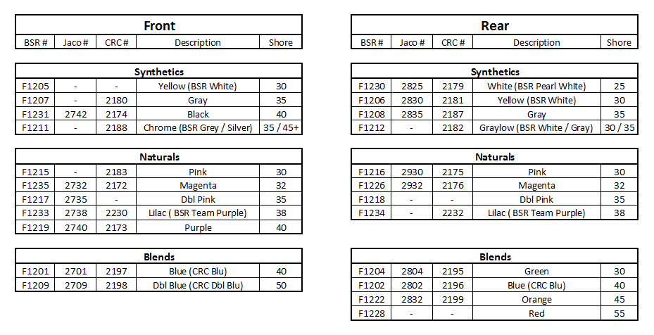

BSR, CRC, Jaco:
Pro One is no longer selling to the public, but it and the brands above are all mounted by BSR and use the same foam. The nomenclature of the BSR vs Jaco/CRC is a little different in a few instances but is otherwise the same. The BSR foam consists of three families, and can be identifed as synthetics, naturals, and blends.
Synthetics - The old school, light weight, easy to true "dry feeling" tires. These include tires like CRC/Jaco Yellow (BSR White), Black, Gray, etc. These tires offer the highest wear rate and lowest grip. Many racers continue to use these nder high bite conditions.
Naturals - These tires are usually the best alternative for low bite and asphalt. They include Pink, Magenta, Double Pink, Lilac (BSR Team Purple), Purple, and other tires. These tires provide a ton of grip, but tend to get sticky in high bite conditions. This rubber does not wear as easily, and the cars will pick up gunk and fibers from the carpet under most high bite conditions. This is especially bad if the humidity is high.

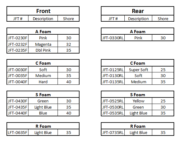

JFT:
JFT stands for Japan Foam Tire. They started the new wave of foam tires we are all using now (Blue/Blu, Green/Greene, Dbl Blue, etc). These tires are a little different than the BSR tire family, but work in very similar conditions. They currently offer four varieties - A, C, S, and R. See below for an explanation of the different varieties. Please note that JFT uses the same foam for fronts and rears, so a C35 front is the same as a C35 rear (for example.) This is different from other brands where a Blue front might be different from a Blue rear.
Most people reference JFT tires using a combination of the variety/family (A, C, R, or S) in conjunction with the shore (30, 32, 35, etc.) This is easier than using colours, as there are common colours across the different families (both C and S have a blue, for example.)
JFT also does offer a stripe spec tire for 1/12 that uses a higher shore A foam with a blue stripe. This tire is comparable to the BSR purple stripe tire, although the JFT version can sometimes feel softer - primarily due to the wider blue stripe that is a softer foam than the BSR purple stripe (actual stripe, not the tire foam.)
A foam = Pink/Magenta/Purple Family. Used on asphalt and black carpet, considered close to the natural rubber variety and are named consistently with other natural tires. A foam is very good on black carpet, although it will wear faster than other foam types. Common combinations (F/R) are A30/A30 or A32/A30.
C foam = C foam is very similar to the BSR Blue/Green foam, or the Ulti X foam. JFT C foam is what started the trend of Blue/Green with Naoto's win at worlds in 2012. This foam wears very well and is good on old grey carpet. Common combinations (F/R) include C35/C35 or A32/C30.
S Foam = Think of this as an evolution of C foam. Korey H likes to call them super blue/green. S tends to have better forward bite than C foam, but with better rotation at the same time. As such, S foam can feel a bit more aggressive to drive. S foam wears well, both on grey and black carpet. S, like R, is probably one of the best compounds on grey carpet. S foam can be good on black carpet, but has largely been overshadowed by R foam - since R is a bit easier to drive and has produced well in 13.5. Common combinations (F/R) include S35/S30 or S35/S35.
R Foam = These are similar to S foam, which means they are, in-turn, similar to C foam (both S and R are based on C foam.) R foam feels like S foam but just a little more mellow and stable than S foam. R foam does seem to wear a bit better than S foam. R foam has been very popular in 13.5 on black carpet for the past several years. Typical combinations (F/R) include R35/R35 or R35/R30.
For general setup, the JFT foam seem to generate more bite than the BSR, therefore the car tends to be a little more aggressive.

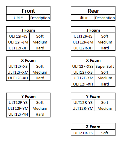

Ulti:
Ulti is another Japanese brand that offers an array of compounds. They have their own way of rating tires, and are difficult to equate to other brands. They have 4 different varieties, each in varying degrees of hardness.
J: High rubber content tire, similar to Pink/ Magenta. Soft would be close to a pink. These offer the most bite and are great for asphalt/carpet front tire. (J hard being very popular)
X: "Balanced" blend, similar to JFT Blue/ Green. Soft is equivalent to Green, medium to Blue in hardness. Great for carpet!
Y: High synthetic blend with lower grip, and is not a very popular variety.
Z: A very expensive "special" foam that is supposed to be magic on asphalt. Only make it in soft shore.
G: -Evolution of the X compound, for carpet high grip (not on chart below)

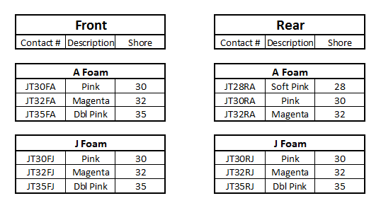

BSR/CRC/Jaco

JFT (Japan Foam Tire)
Ulti
