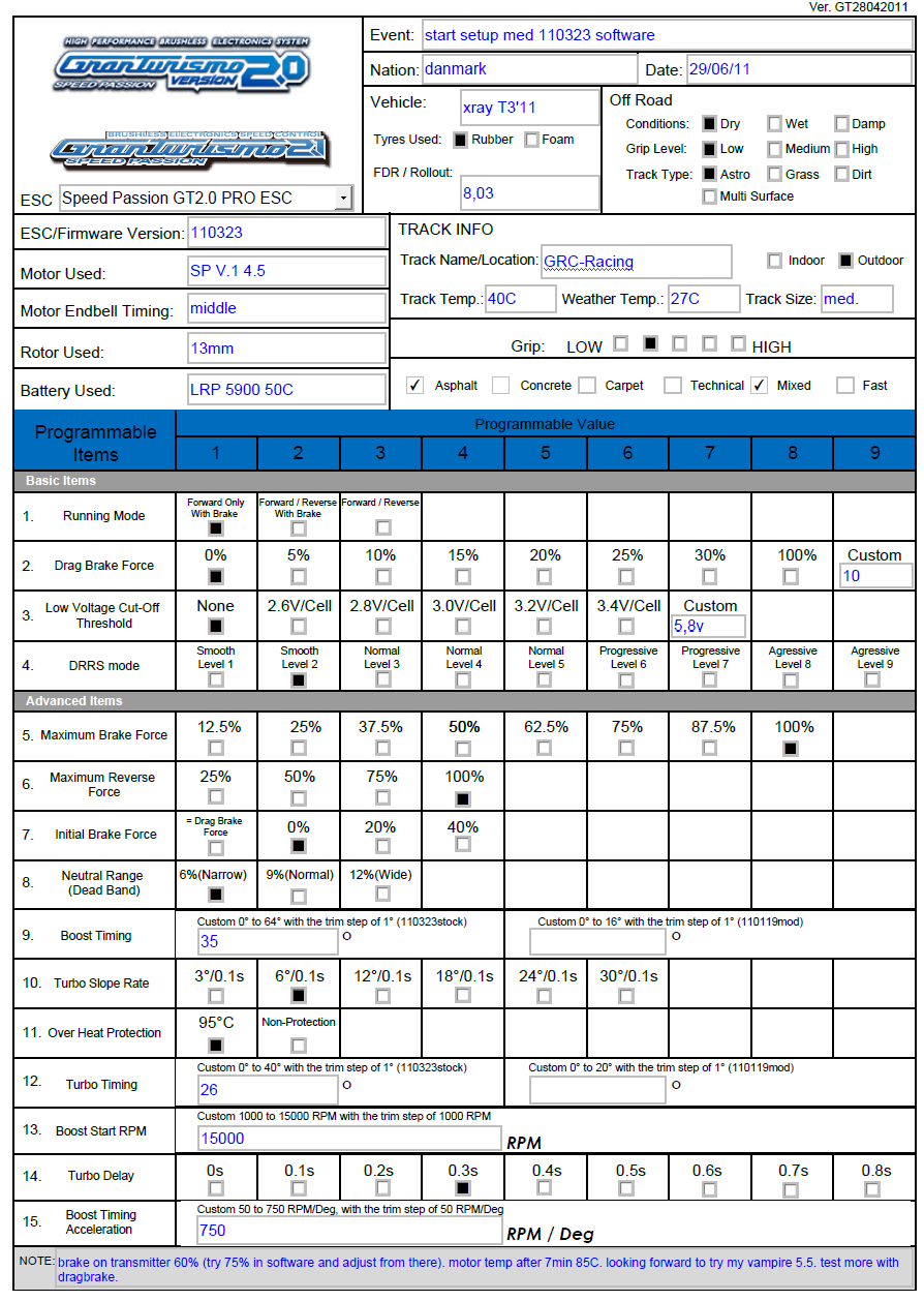

try my setup really happy with it but has a bit to much power with a 4.5
Hmm I ran exactly these settings yesterday (sourced elsewhere) with a 4.0 and I had no top end whatsoever, I ended up going back to 528 mod and had heaps more power, thinking now that maybe the settings didn't send to the ESC properly. The track I was running on had a 62m straight
that funny, had the same experience with both a 4.0 and a 5.0 the 4.5 feels like it has more top speed, like the 4.0 and 5.0 dont respond very well with timing.
did you also had problems with the motor overheating ?
