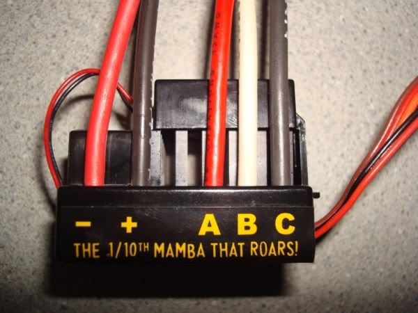

I just picked up a Brushless Castle 1406 5700kv Motor. My speed controller has ABC on it and the motor has wires BLK,RED,WHT, so how do I know what is what?
Help please.

(A)Red (B)White (C)Black
Help please.
For sensorless motors it doesn't matter. If the motor spins the wrong direction simply switch any two of the wires and it will spin the other way.

Thank you for the picture.
Nice to know.
Thanks
