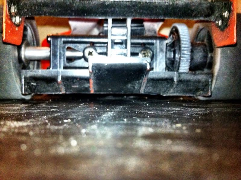

I had promised months ago id post pics of the last rendition of my aero updates when i had my car back. Well, now i have it so here they are
black intake scoop, made with some mesh from a laptop
rear skirted diffuser
I cut the strakes out as i saw they caused flow separation. Though in hindsight the middle ones shouldnt have been cut off.
And my fav, the front diffuser V3. Its much lower and shallower than before. The prefious one was stalling bad, so making it lower and shallower improved efficiency (to the point of having to make the rear diffuser to keep the reaar even more planted at speed.
Sorry if the images look weird, i used a filter so it would show all the details under the bad lighting
