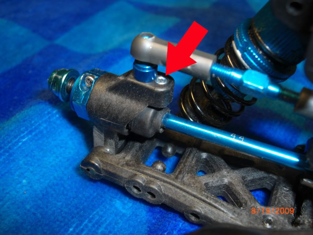

Oh and the picture I said I would post again...Arrow pointing to where I have installed a 3mm setscrew. Like I said it strengthens this area. Very easy mod to make and could save you from a DNF during a race due to a accident[IMG][/IMG]

Timmie, in your picture, I notice you put a boot for your UJ. That's a neat idea to keep dirt/sand away!
By the way, what did you use for that? A heat shrink tube?
Cheers!!
Hey ya caught one of my mods lol. Yep heat shrink tubing Awhile back I was rebuilding my axles..(used to do it every week) and started thinking hell with this Originally I used a nitro slide carb boot and a small wire tie..looked just like a baby cv axle out of a front wheel drive car HEHE! But settled on a simpler idea, and used shrink tubing. I have only replaced my axles one time in 6 months of racing since doing this mod. And I drive very aggressive so thats really good. Only trick to this mod is getting the ones up front the right length. If you use a piece that is too long it will bind one the front shaft in a tight turn. I plan on covering how I build axles in the write up I'm working on.
