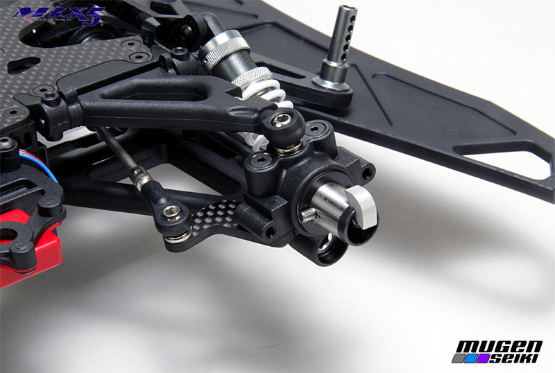

Old 09-18-2014, 06:22 AM   #3837
Stuff Of Legend's Avatar
Join Date: May 2010
Location: Dark Side Of The Moon
Posts: 234
Default Tilted Front Upper Arm
Hello
Question about why you guys tilt the upper front arm forward/backward with the RWD pan cars, its been bugging me for a will now.
I understand with the rear lower arm it gives you anti swat/pro swat.
Coming from a nitro background were my car has the option to tilt upper arm forward/backward(image below).
My car is 4WD the pan car is RWD but i think the same principles will apply.
Will it give more front traction corner entry/exit
More steering response corner entry/exit
Make car easier to drive
used in high/low traction conditions
Thanks

It is our caster adjustment

It decreases the caster as the suspension travels, to pick up steering mid corner.

hum! ok thanks
You have pointed me in a direction
back to back testing then
