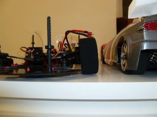

Questions??
i think that i have too much camber for starting rounds.. what do you think?0 dregree dynamic caster,5mm height front..some advice please for tweaking...i am a new guy
