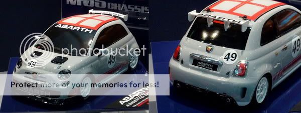

Originally Posted by tony gray View Post
Due for release 22nd October...
wow that's ugly! They should have came out with the original!
Me likes it....
