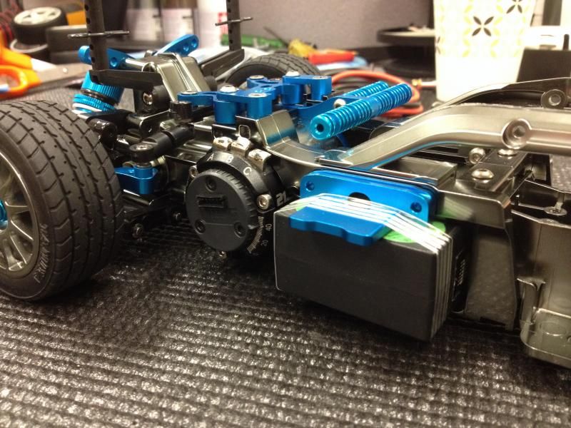

Here's some more pics w/ the shorty pack and brushless motor fitment. I'll bring this car to the Tamiya Raceway tomorrow.
Did you have to shim the motor out to clear the tabs? did you try out other motors? thanks
No, and "not yet". I have a speed passion in an M03 that will fit no problem because of the side ports for the wires. I suppose some test-fitting may happen for the guys at the Tamiya track tomorrow when I show the car.

B/L motors will fit nicely and the tabs appear to clear. The motor doesn't seem to buried so the overheating worries I had may not crop up. Also the lower positioning of the servo may be a positive on some tracks and with the 55m tires.
