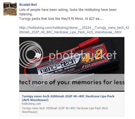

For anyone who doesn't subscribe to our FB page.

There are a few of those being run in mini here. Good batteries. Anyone know if Hobbyking has gotten over the international lipo shipping problems yet?

Statement about the battery says "looks like they'll fit Minis" so anyone know if they do. Hard to tell by the photo.

They do fit fine in the M05! The only thing is you have to trim the opening in the removable battery holder part a bit so that the grommet of the battery can go through.
See photos at http://sgcrawlers.forumotion.com/t14...y-compartments

I've been using these packs for a little over a year now. I didn't trim my M05 battery cups (the grommet it a bit squished). I even have a few weights added to the underside of the pack, no problem. It's a REAL tight fit in my M01, though, but that car is relegated to shelf duty now.
