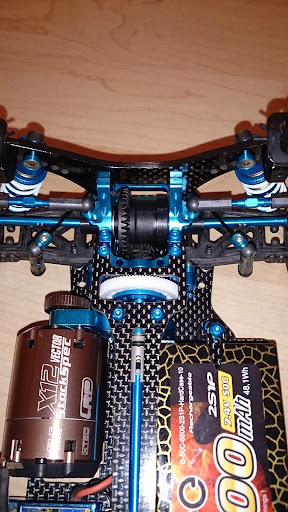

Does the EVO 5 16T Bevel pinion gear (51255) work with the EVO 4 Steel ring gear (53721)?

the tooth profiles are all the same throughout the TB range. it will just be a matter of shimming and spacing. never personally tried it but should work (the gear is aluminium)

just tried it, fit right in on a tbo3 spool. might need additional shimming for ring gear cause of the dish shape on the back of the evo4 gear moves the gear away from the pinion gear. try to show pics but they are here in my rc tech page
