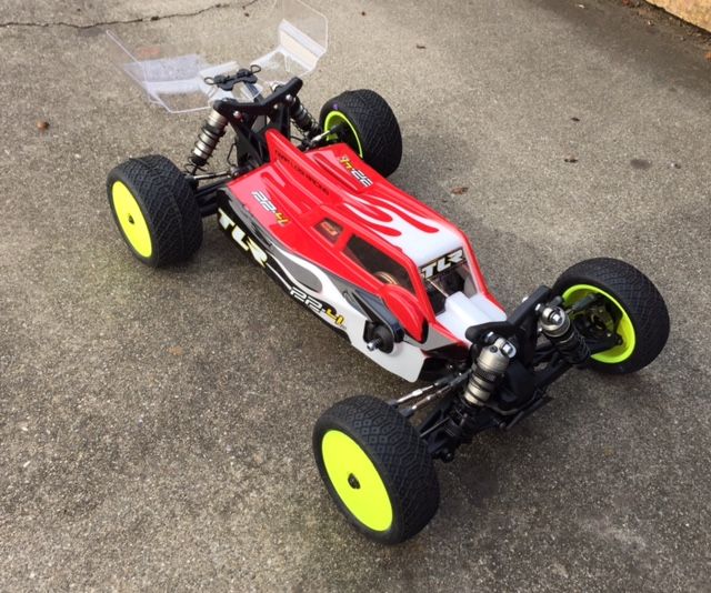

Got to run the buggy for the first time today, wow, kit setup is dialed! Rear was a little bouncy (maybe need to break in the springs), so I switched to a LF yellow spring, but didn't touch a thing otherwise. This is the best out of the box setup I've ever driven on any vehicle. Nice job TLR!
BTW, what does a skipping belt sound like? Heard a bit of crunchy noises from the rear under power, I'll tear off the rear cover tonight and check it out. I assume it's nothing too horrendous sounding, this wasn't a skipping ball diff sound or anything that scary.
