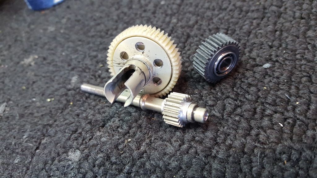

I got some new outdrives today to go with my B6 and B6D cut gears.
You know, copying others...Oh wait, no one else in the country has B6/B6D cut gears...or these outdrives

First off, i have a lathe and made cuts gears day 1
second i've been running symilar diff outdrives for over a year in b5
made them in house
nothing new here
RC RACING DESIGNS..

Originally Posted by slick1 View Post
First off i have a lathe and made cuts gears day 1
second i've been running those diff outdrives for over a year in b5
made them in house
nothing new here
gonna have to pull a trans apart just to picture
The drilled out drives was done a while ago. pictures appeared on liverc around cactus last year i think. I know a couple locals were doing it. Still, stuff like this is what makes this truly a hobby. Socket didnt invent the lightened out-drives, but he took the initiative to do his own.
only one huh
First off, i have a lathe and made cuts gears day 1 cool story, how was he to know
made them in house again, cool
nothing new here
gonna have to pull a trans apart just to picture don't worry about it, we believe you
only one huh
made them in house
nothing new here
Looks good. I turned my top shaft down also. Good work soldier.
Edit: Now, drill the diff gear out between the bearing and the diff balls. A lot of material to go there as well.
already machined some gear diff outdrives to fit brass rollers in pucks,,
was not easy, material is so hard,, but works well, wares the brass rollers
if you land hard on one side ,, the outdrive can scar the shaft,, but price of going fast,, can break the bone/shaft
RC RACING DESIGNS..
slick1 is offline   Reply With Quote
works well,
Can you take away some material at the end of the outdrive to prevent this?
ya... doing any kind of machining to hardened outdrive is like a career!!!
I have zero interest in machining hardened steel.
I did however order the Bimetal diff kit for the roller pucks. Going to drill those drive plates as well, and use the alloy bones with my ti axles.
