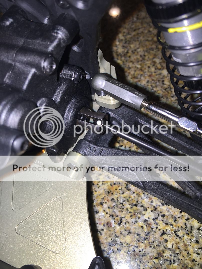

Is this normal at full droop kit setup? Awful close to end of outdrive.
If its not normal, any suggestions on what I did wrong?
That is fine, it won't pop out.
BTW, your rear camber block is on upside down
Thanks Frank.
I saw that after I posted the pic and turned it around already.
