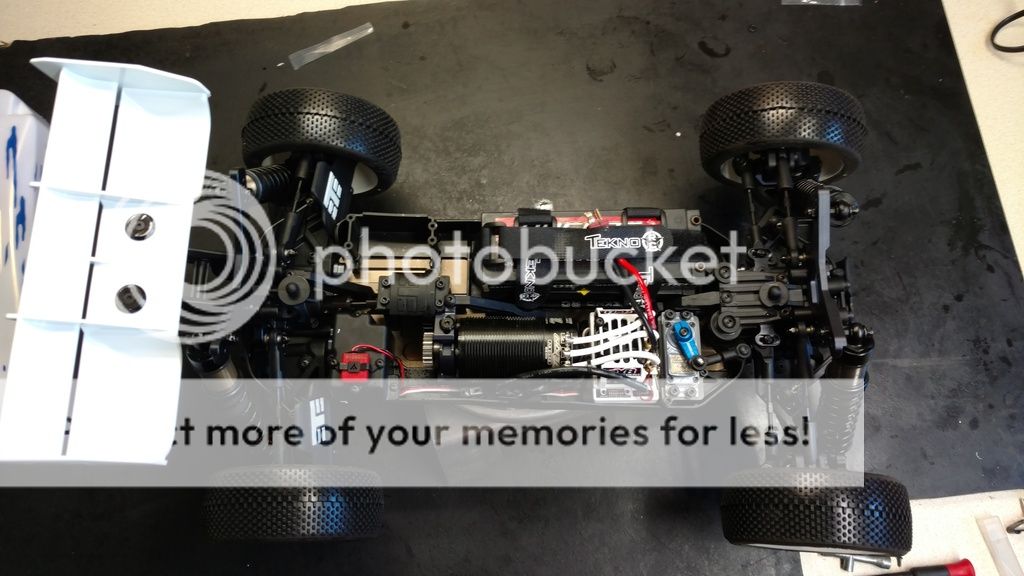

Finally finished her up. Parts quality is right up there with xray. Ran into a few hiccups but other than that kit went together very well. Suspension is so plush. With a tekin t8i, Skyrc Toro150 and smc 4500 4s pack my buggy weighs in at about 3311g. Won't be able to run her yet as I'm feeling under the weather but here are a couple pics.
nice paint sheme ! good to see some eb48 pictures !
